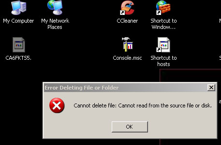

Ok, I've been trying to tackle this for hours, days even. I've seen lot's of other activity on this, but have not found a suitable solution. This is my last hope!
There is a file on my desktop that I cannot delete, named del  "CA6FKTS5."    (no quotes)
It is greyed out and anytime I try to move it or delete it I get the error:
   Cannot delete file: Cannot read from the source file or disk.
   or
   Cannot move file: Cannot read from the source file or disk.

The file name is obviously invalid, but I have been able to employ any of the previously discussed methods for escaping those invalid chars and calling del at the command prompt. It looks like lots of other people have success with that, so I'd just stumped...
I've added a pic of my desktop just so you don't think I'm screwing with you :)
I'm on Windows XP SP3

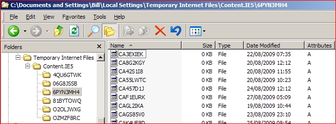

by: BillDLPosted on 2009-08-26 at 22:23:39ID: 25194830
I don't think it is a coincidence that the name is the same format as a Temporary Internet folder name and file name.  See screenshot.  I would certainly delete the contents of the Temporary Internet Files to start with.
