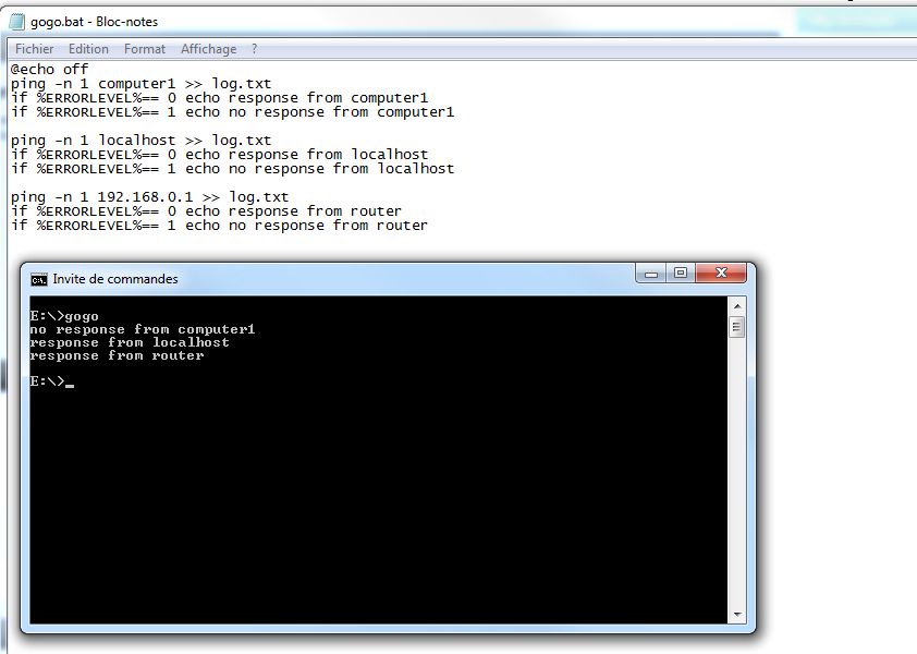

by: leakim971Posted on 2009-10-14 at 20:50:33ID: 25577064
Example :

by: leakim971Posted on 2009-10-15 at 08:33:51ID: 25581633
Hello dragon-it,
Check my screen copy, it's not a fake !
Regards.
by: QlemoPosted on 2009-10-15 at 10:25:43ID: 25582676
I can confirm that. But I have been certain that Steve is right. However, looking into one of my archived batch files, I have used that previously with the || syntax ... Applied to my example, which I still prefer because of the built-in delay (in milliseconds) and suppressing unnecessary output, that is only a small change:
