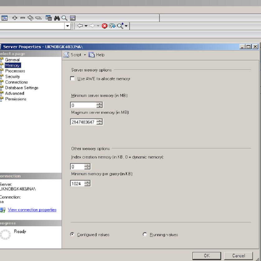

by: slam69Posted on 2008-03-17 at 06:41:33ID: 21142005
to follow up on PAKA just for info
if you right click the instance of sql server from teh management studi interface and sleect properties there is a memory page option in there that allows you to set the maximum server memory

Oops!  Looks like SQL2005 does not have a limit memory option anymore - I was thinking to SQL 2000.  What else are you going to run on that server that will need SQL memory limits?
by: slam69Posted on 2008-03-17 at 06:49:28ID: 21142073
Err sql 2005 DOES def have a max server memory to use option within the instance properties

by: slam69Posted on 2008-03-17 at 08:12:21ID: 21142890
sql server will use the maximum available memory you tell it it can have
the above way to set the max limit is PER INSTANCE therefore an understanding o fthe number of instances you have run would be needed to work out the division.
As kcts states once the image of the standard 2003 has been done you will then need to perform an inplace upgrade to enterprise so that you can realise the additonal ram you have
