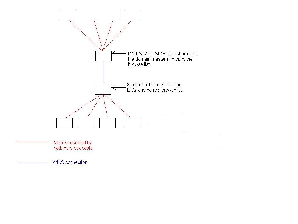

Separating the Browser service from AD and DNS, (as I should have done), the remote site DC should be a master browser. Then, that DC should talk to the PDCe through a WINS connection. This is the only time WINS is really needed for the Browser service.
If all of these computers are on the same site and don't have to go through a VPN connection, over NAT, or need to be routed in some way then allyou have to do is elect Netbios over TCP/IP. The browselist is populated by netbios broadcasts from the client and acknowledged by the server on Netbios port 137 and UDP ports 138 and 139. Using the word "transport" is more of a figure of speach and you are right that DNS is a mirror image of WINS. The free body diagram I drew up for another post illistrates when WINS is really necessary.
