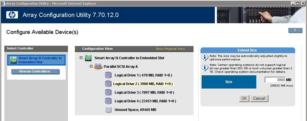

by: nourbenPosted on 2009-10-07 at 05:53:57ID: 25514786
It looks like the Array config let me extend the logical drive, but I have never done it, is it going to format the new space to NTFS and extend the Logical Drive 2 (which is my boot partition)??
See attachment
by: garycasePosted on 2009-10-07 at 11:24:27ID: 25518331
Clearly it allows you to dynamically resize the array.   This almost certainly is an "online capacity expansion" .... meaning it will expand the size without any loss of data ==> but I would nevertheless be sure you have a current image of all your partitions before doing so.    Backups are ALWAYS a good idea :-)

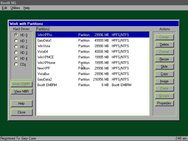

You can download the free demo of Boot-It here:  http://www.terabyteunlimited.com/bootit-next-generation.htm
The free demo will do what you need, although it's well worth buying a copy of this very handy utility.    To use it, just run MakeDisk to create a bootable floppy or CD;   boot to Boot-It;  select CANCEL at the first prompt; then OK.    Then click on Partition Work, select the disk you need to modify [The disks will show as HD0, HD1, HD2, etc. on the left side of the partition work screen];   then highlight the partition you need to expand (in the center part of the display), and click on ReSize on the right and when prompted enter the new size.    Once it finsihes, you're done.  The resize operation will just take a few seconds.
Here's an example of what the partition work display will look like -- this system has 5 drives and is currently displaying the partitions on the first one (HD0).
