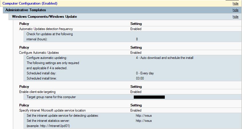

The automatic restart is configured in the configure automatic updates settings. You have number 4 selected so that should be correct. I only have 4 settings defined for my WSUS policy and the installs/reboot work correctly. I have attached a screenshot of my gpo settings. Im not sure about the no auto-restart policy you posted that may be messing with your updates.

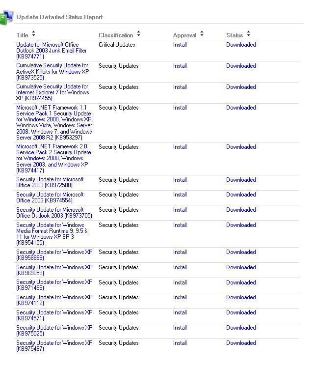

these are the updates that arent being installed automatically. why?
    • 91 KB
    updates that arent being install automatically
