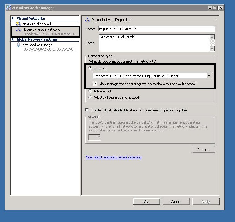

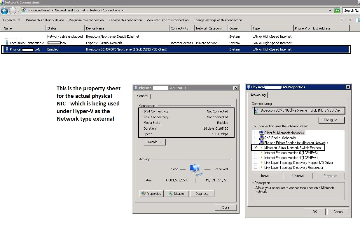

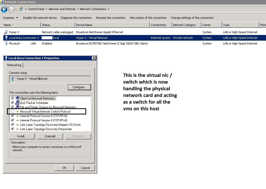

by: mutahirPosted on 2009-11-02 at 06:58:23ID: 25719911
I have attached the screenshots
This server is using ONE NIC and have Hyper-V
Make sure your settings are like this, basically on your actual real physical network card you would only have "virtual network switch protocol" binded and nothing else ;
On the Virtual Nic hyper-v creates, that will have the IP address and will have everything checked apart from "Virtual Network Switch Protocol"
Check your settings as per the screenshots and post back your findings.

mutahir-  The screenshots you posted are exactly how my single NIC configuration is/was setup.
