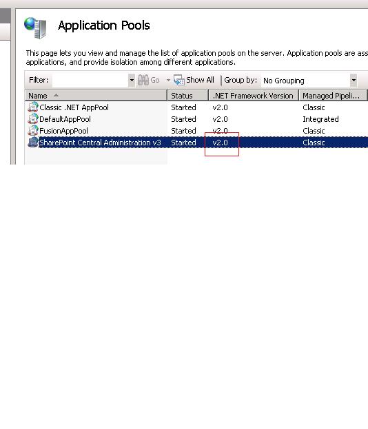

by: techcityPosted on 2009-04-30 at 00:03:54ID: 24267524
Hi Poortatey,
I have run the script and successfully installed WSS 3.0 w/SP1 x64.
I opened  IIS Manager, clicked App Pools, I saw "Sharepoint Central Administration v3" is one of the listed items. However, the version of .NET Framework associated with it is "2.0", which I expected "3.0"
Is this a problem?
jack
by: poortateyPosted on 2009-04-30 at 06:11:13ID: 24269541
Nope!  Sharepoint is an asp.net 2.0 web app. It uses .net 3.0 for things like workflow and core services.

by: techcityPosted on 2009-04-30 at 07:50:24ID: 24270534
I did the install of WSS 3.0 yesterday afternoon, we briefly tested the third party web app okay
I re-registered 64-bit ASP.NET as you mentioned yesterday late night, I have not heard of anything from users yet. By the way, what's the purpose to re-register 64-bit ASP.NET?
Can you please check your IIS7 and see what version of .NET Framework is being associated with Sharepoing Central Administration 3?
MS Doc says that WSS 3.0 is a .NET Framework 3.0 application and .NET Framework 3.0 must be pre-installed, which i already did. I just would like to confirm if this is a problem before i proceed in further.
Thanks a lot and have a good day
jack
by: techcityPosted on 2009-04-30 at 07:56:15ID: 24270612
I attached the screen shot for ya
by: poortateyPosted on 2009-04-30 at 08:38:58ID: 24271138
The web app portion of sharepoint uses .net 2.0, and the WSS services use .net 3.0. They both need to be installed. I suggested reregistering 64bit asp.net in case that version had been set for your 3rd party webapp. But if everything is happynow I guess you're set.
