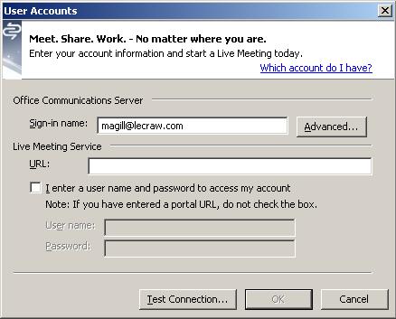

Not to sound Stupid, but where is the LM console -- this did not install as a seperate app -- all that is installed on my client (in respect to this) is Office 2007 and the Communicator 2007 R2 (14+MB Install)
This has given me the communicator IM agent (which does seem to have access to Live Meeting) and the Outlook plug in.  In Outlook I have tried every possible combinations of server names/ports etc.  to no avail.
I have attached a sceenshot below of the account config screen in outlook (leaving the server name blank fails)
Putting in either an IP address, or name of my server, for example https://JLCOCS01.lecraw.com/  passes for the first part when you press test, but fails when you press OK

by: jaycaPosted on 2009-03-18 at 01:05:22ID: 23916370
If you are using automatic configuration (have the correct SRV record).  Then install the LM client.  Configure it just as you have in the pic.. and test it and get a success.  (You might get a fail with the LM Service portion, don't worry about it)
Once that is done and you click okay.. you should see a MEET NOW button.  You can then click it and be joined to the meeting.
Your issue is you are trying to configure the settings for the LM client without having it installed... don't sweat it :)
In a nutshell.. all you need to do is install the Live Meeting client... the current client you can get from http://office.microsoft.com/en-us/help/HA101733831033.aspx
If the link does not work, goto livemeeting.com, then click on download resources and it is listed.
GL!!
by: KaffiendPosted on 2009-03-18 at 16:07:51ID: 23924813
Just to be clear, you don't have to put anything in the URL text box.  Leave it exactly the way it is in the attached jpg file and just click on "Test Connection".
by: Dan_MaGillPosted on 2009-03-23 at 10:02:34ID: 23959871
This does not work --
I installed the LM Client per the above link (the dialog box is the same for Outlook plugin).  This does not work either
can I manually recreate the SRV records for the DNS?
