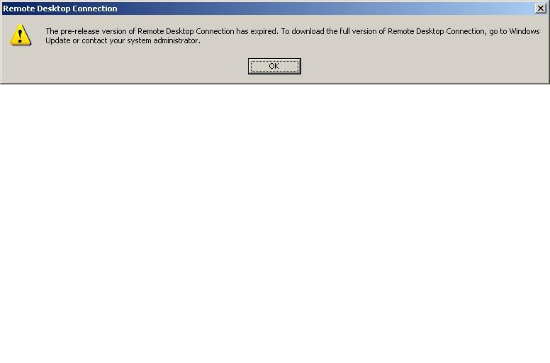

Hi everyone
Was surprised to come across an error message which i have attached below. Tried google search but was not able to come across any solution.
Please suggest what i can do to get rid of this message my operating system is Windows XP PRO SP3.

by: dlan75Posted on 2008-04-07 at 01:42:00ID: 21295152
SP3? Maybe that is where your problem comes from ...
As said in message, either go to windows update and check if there is a newer version for RD or you can download it from MS Website. Try this one for example : http://www.microsoft.com/downloads/details.aspx?FamilyID=26f11f0c-0d18-4306-abcf-d4f18c8f5df9&DisplayLang=en
by: ehabsalemPosted on 2008-04-07 at 01:46:08ID: 21295166
Overwrite these two files from older xp sp2:
mstscax.dll
mstsc.exe
See: http://forums.microsoft.com/WindowsHomeServer/ShowPost.aspx?PostID=3128216&SiteID=50
by: KCTSPosted on 2008-04-07 at 01:51:27ID: 21295188
I suspect it is SP3 that is causing the problems - SP3 has not yet officially been released so you must be using the Release Candidate. If you are using RC1, then you can update to RC2 which should cure the issues, or roll-back to XP-SP2
by: KASPBoodaiPosted on 2008-04-07 at 02:12:51ID: 21295271
Hey thanks a lot RDP is now working after i replaced those 2 files from winxp sp2 system. Strange why the existing RDP on SP3 failed, i assume rdp is inbuilt and it should have never prompted me to install full version of rdp anyways thanks once again.
by: ehabsalemPosted on 2008-04-07 at 02:16:19ID: 21295283
Please note that what KCTS said is correct, SP3 officially not yet released.
by: siteoutfittersPosted on 2008-05-12 at 06:07:31ID: 21546569
Now that SP3 IS offically released I encured the same error.  I will apply the overwrite as well and comment if that doesn't take care of it.  Thanks!!
