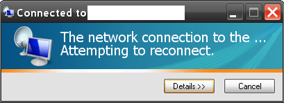

I have successfully setup and configured the TS Gateway and have several users who can connect to the GW and launch the apps. However, I have a few random users who cannot launch any of the remoteapps.
They receive the following error: "Windows cannot start the remoteapp program. The following RemoteApp program is not in the list of authorized programs: Calculator. For assistance, contact your system administrator"
Also, I used Calculator as a test. It doesn't matter if it's an Office app, utility, or RDP link. They all get the same error. Once I click the okay button, the session seems to try to continue to connect anyway, and then I get the window that says the connection has been lost. Other times, I get a small window with the Server 2008 logon screen.
Some additional info: The site has a paid-for SSL certificate and is working properly (other users can connect just fine). One of the user accounts we have had trouble with is in the same group as the rest of the users, but is also an administrative user. We have tried from several different physical remote locations on several different comptuters. Some of the OSes we have tried this from are Windows XP Pro SP3 (RDP 6.1), XP Home Edition, and Linux (Fedora 10). The same user is able to log in to the term servers just fine. He is also able to log into the management server remotely as well.
All current patches and recommended updates have been installed. Access has been tried with both firewall on and off. It's odd how other users can connect without any issue at all, but not a few different accounts. One of the other accounts is a non-administrative account. If I log in as administrator, I can also access the apps.

The error window I receive.
This appears after I click ok...
