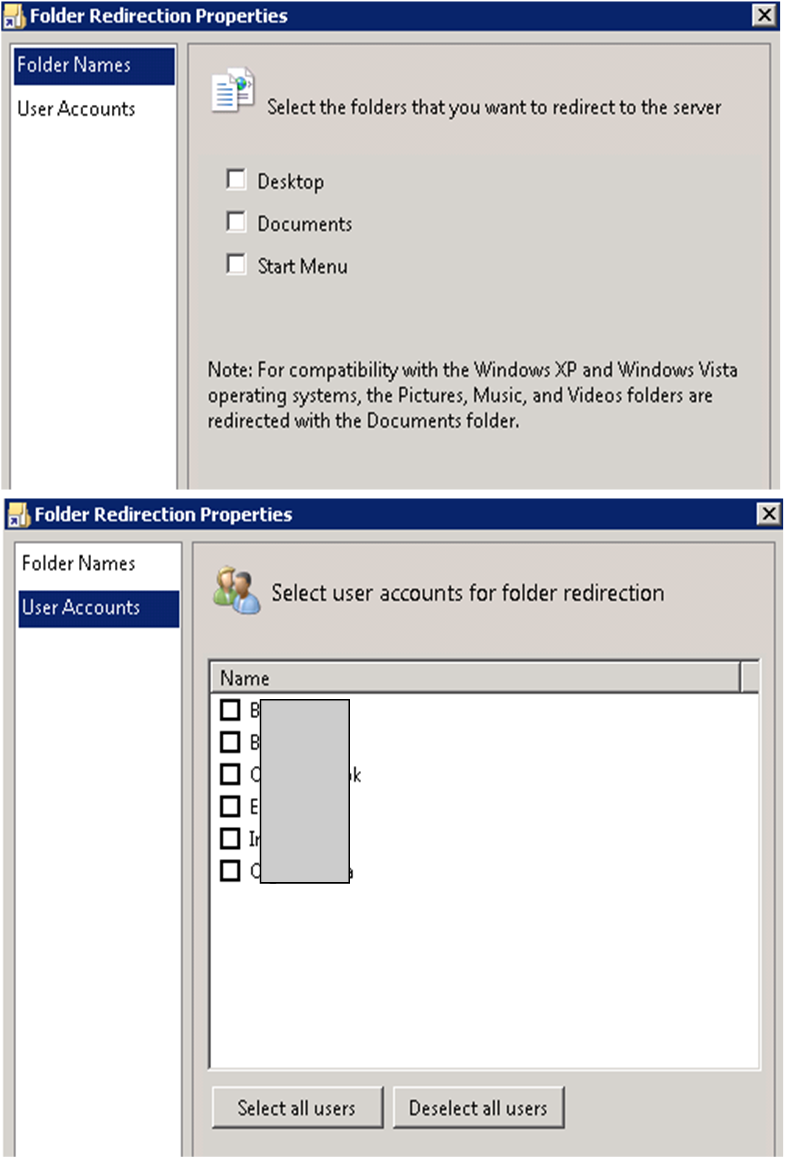

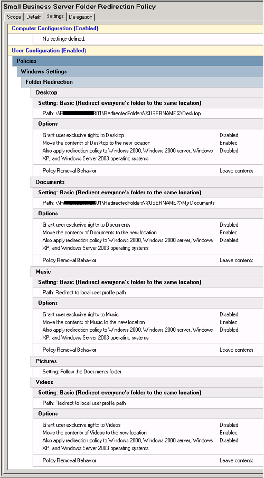

Setup a new SBS 2008 server and am confused about Folder Redirection settings - I have the Group Policy object set the way I want and I expected the SBS Console settings to be updated (to match the GP settings), but they're not.
See the attached screenshots
Question - If the Folder Redirection Group Policy exists, why aren't the settings updated (reflected) in the SBS Console? Is this just a glitch that can be safely ignored? Or do I need to check off the redirection boxes in the SBS Console too? That doesn't seem to make sense, so if it is necessary please explain why.

SBS 2008 manages the Group Policy settings in the background. When you enable FR in the SBS Console, it will always redirect to the default SBS 2008 folder locations.
If you want different locations and settings on that GPO, then you will need to manually change the GPO and ignore what the SBS console says.

by: scion111Posted on 2009-11-06 at 14:57:19ID: 25763807
Thanks for the comments. This is not a migration - it is a clean install / new setup.
MPECSInc:
You said:
"SBS 2008 manages the Group Policy settings in the background. When you enable FR in the SBS Console, it will always redirect to the default SBS 2008 folder locations.
If you want different locations and settings on that GPO, then you will need to manually change the GPO and ignore what the SBS console says."
I did make some adjustments to the GPO settings (not redirecting music, etc.) and the GPO seems to bee applying fine. I assume that means I should just ignore the SBS Console view (that would make you think, since nothing is checked off, that no Folder Redirection is setup).
Is that correct?
by: himvyPosted on 2009-11-10 at 11:40:50ID: 25788936
 Yes that will work.Run gpresult and it should show the policies getting applied.
by: scion111Posted on 2009-11-10 at 11:58:03ID: 25789103
I just want to be sure that I should just ignore the SBS Console view (which, when viewed, shows nothing is checked off, implying that no Folder Redirection is setup).
Also, does anyone know if I DO check anything in the SBS Console, will it OVERWRITE the policy settings I setup manually in GP Management?
by: MPECSIncPosted on 2009-11-10 at 12:16:12ID: 25789308
Yes, ignore the console as you are manually managing the GPO.
Yes, you check things off in the SBS Console, and it will reacquire the settings in that GPO.
Philip
by: scion111Posted on 2009-11-10 at 14:13:56ID: 31651085
Thanks for clearing that up! Not very intuitive - too bad the SBS Console doesn't throw up a message/warning saying that the Redirection has been manually configured.
