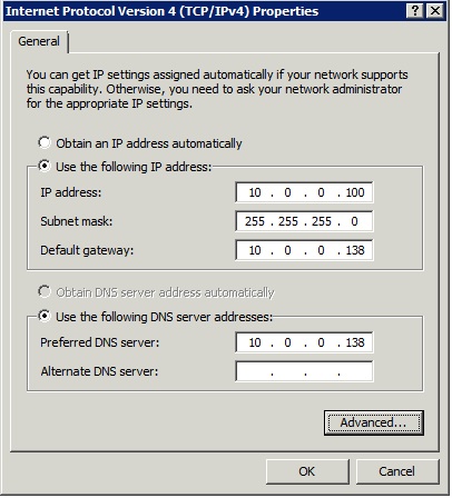

by: jrfaustPosted on 2009-08-11 at 20:14:04ID: 25075467
Assuming that your default gateway is 10.0.0.138, then your TCP/IP properties should look like this:
by: awolarczukPosted on 2009-08-11 at 20:21:46ID: 25075511
thats what is looks like :) always has

by: jrfaustPosted on 2009-08-11 at 20:29:25ID: 25075548
Check the Advanced settings and make sure that there is only one default gateway listed there.
by: PriceDPosted on 2009-08-11 at 20:36:16ID: 25075565
Can you send the screen shots of the IP setting like jrfaust show.  Also, attache screen shot from the advance tab as well.
by: awolarczukPosted on 2009-08-11 at 20:40:04ID: 25075574
all good under there

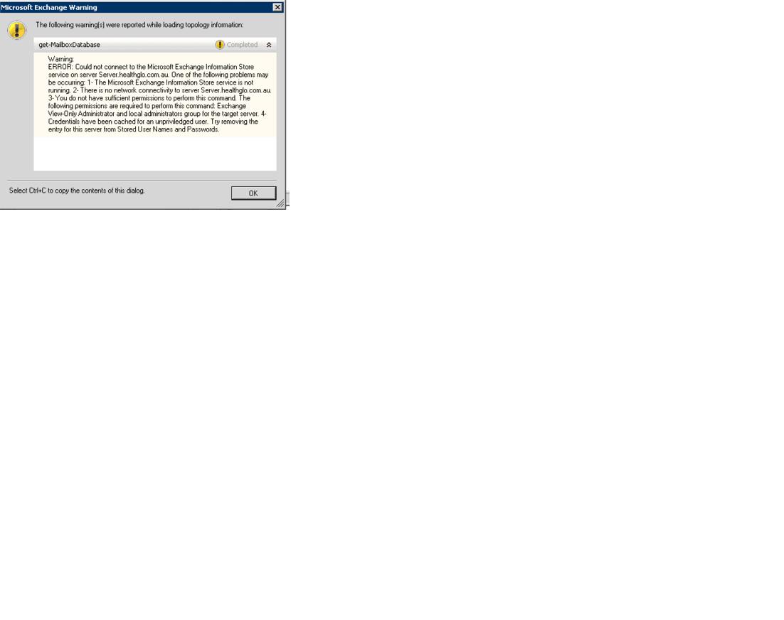

by: awolarczukPosted on 2009-08-12 at 00:11:03ID: 25076287
this is the exchange error i am getting when i try to use exchange have restarted all service and didnt make a difference

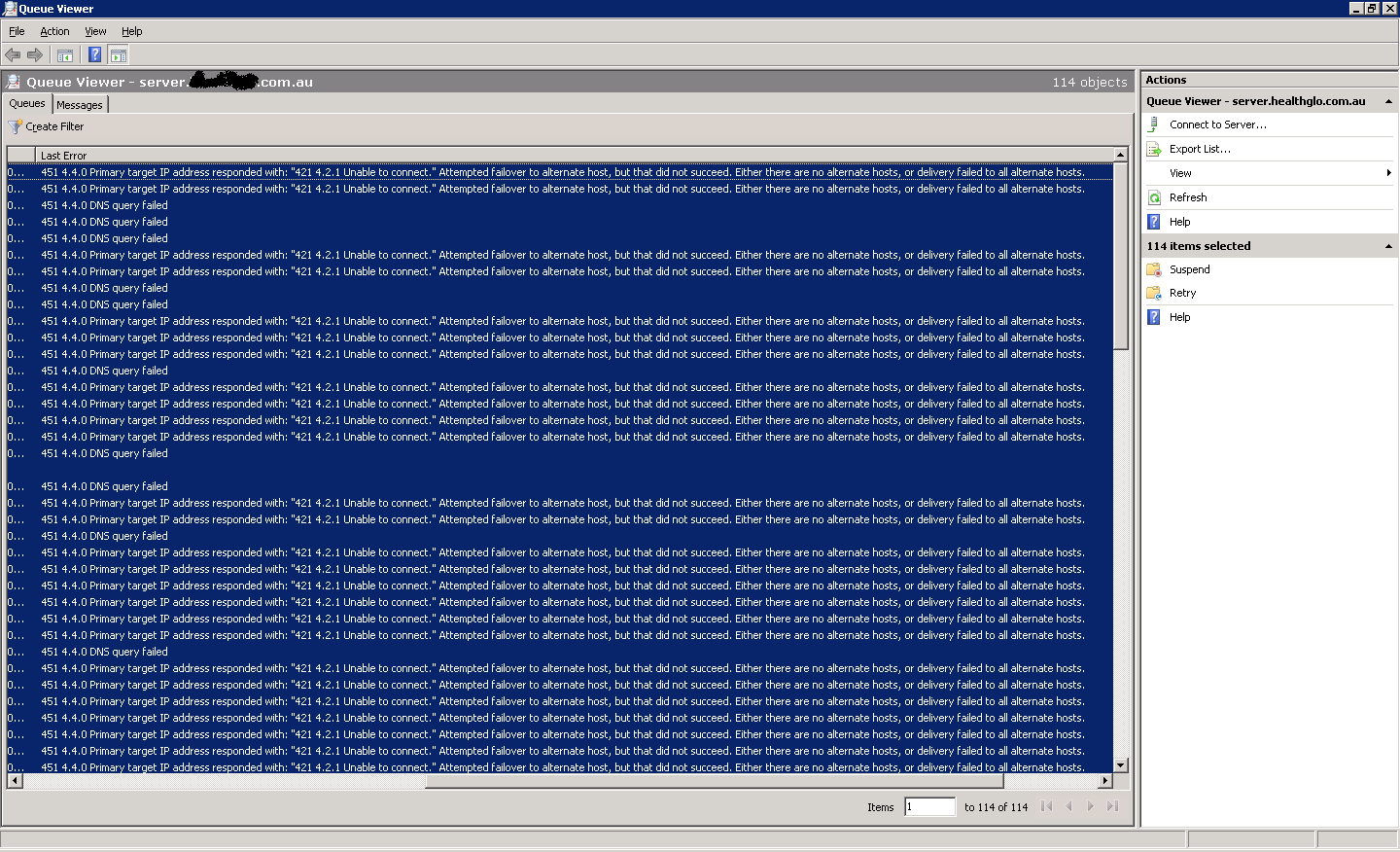

by: awolarczukPosted on 2009-08-12 at 17:06:37ID: 25084504
ok most of it is now up and working but i am now getting this error when i try to send to most email address
