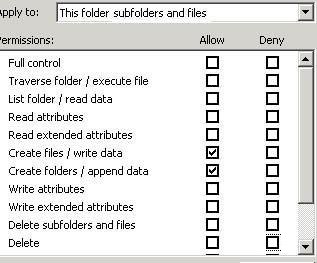

I have created a folder on a file server that a particular user group can copy files to it, but cannot enter the folder or change or take away any information from it.
I did it using special permission setting shown in the image below. It works. The only problem is when I try to map the folder as a Network Drive via a log on script, the permissions setting prevent this.
What can I do?

by: Jason210Posted on 2009-11-03 at 09:58:50ID: 25731631
I forgot it. Here it is...

by: Jason210Posted on 2009-11-04 at 00:28:09ID: 25737364
I allowed "Read Permissions" and I allowed "List folder / read data" and it still won't map.
by: Jason210Posted on 2009-11-04 at 00:52:21ID: 25737472
Kentern
I'll try to be as specific as you want. This scenario is a test that illustrates what I mean by "permissions work as planned on normal folders" and  "it works".
  1. On a file server. Admin creates folder A and makes Folder A a share. Share permissions are set to "everyone, full control". Security permissions of folder A are set to "modify" for the user group.
  2. Nested inside Folder A, admin creates subfolder B. and sets special permissions on subfolder "B" to allow "create files / write data", and allow "create folders and append data" and "Read Permissions"
  3. "Folder A" is mapped as a network drive. This works fine, and when the user looks inside it, the user can see folder B. The user can drag and drop files into folder B, but cannot look inside it, or change existing data inside it. This is what I mean by "permissions work as planned on normal folders" and  "it works".
However, this folder A and folder B structure is not what I want. I just want Folder A, with permissions set to allow "create files / write data", and allow "create folders and append data" and "Read Permissions". The issue is that it does not appear to be possible to map a folder with such permissions, because it the log on script that tries to map the drive returns the error "The stated network name is no longer available".
by: Jason210Posted on 2009-11-04 at 01:01:52ID: 25737525
I've been going through the permissions, one by one, and only when I turn on traverse folder, execute data, will the folder maps. But now the user can traverse the folder and see what's in there, which is not what I wanted...
by: Jason210Posted on 2009-11-04 at 01:42:41ID: 25737698
A folder set with these permissions cannot be mapped, which is stupid.
