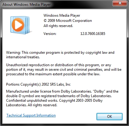

Do you have WMP or a dvd decoder such as Power DVD?
by: Idle_MindPosted on 2009-08-28 at 10:43:36ID: 25209930
WMP is installed as part of the OS...see my screenshot in the original description above.  =)
I do NOT have any third-party DVD applications installed.

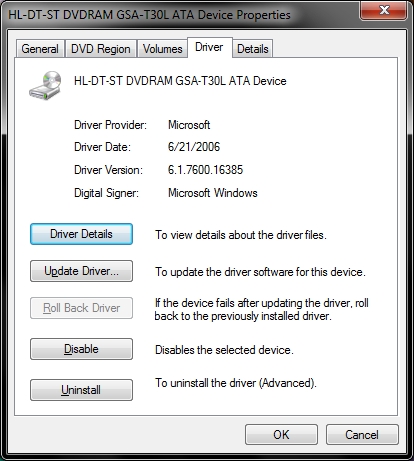

Tried deleting the Drive in Device Manager and letting Windows reinstall it after Reboot...didn't work.
I think I'll just have to wait for HP to update their Driver for Windows 7?

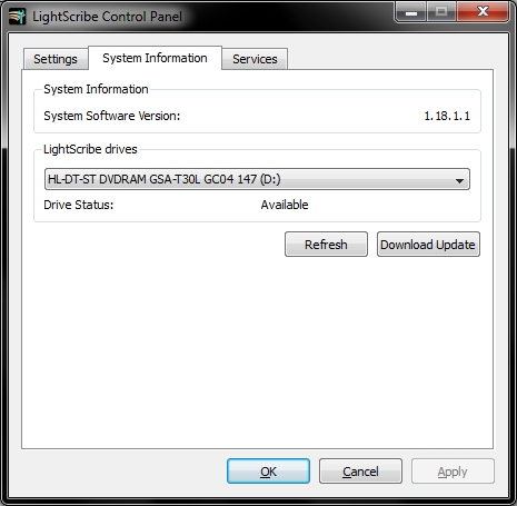

*oh, the screen shot is the LightScribe software...it doesn't really do anything.

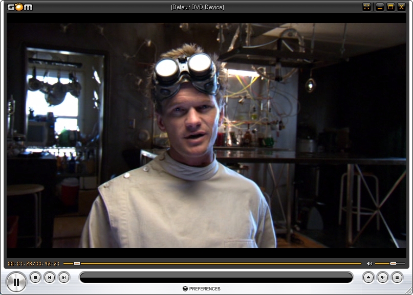

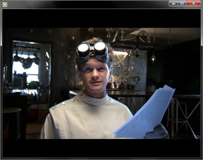

Woohoo!...so I downloaded and installed "GOM Media Player":
http://download.cnet.com/GOM-Media-Player/3000-13632_4-10551786.html
...and now I can play DVDs in the GOM player AND in Windows Media Player.  =)
I was really surprised since the more popular VLC and various "codec packs" did not work.
I did notice that in the GOM Player I can't select the DVD Menus with the Mouse but I can with the Keyboard...and it doesn't properly show the currently selected Menu Item.
No matter, though, since I can now watch the move (and select the menus w/ the mouse) in Windows Media Player.
