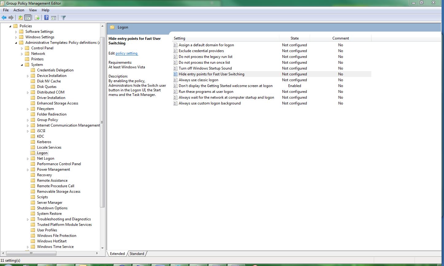

by: CAGdorfPosted on 2009-11-04 at 11:31:15ID: 25742952
A pic from my earlier post
    • 152 KB

by: CAGdorfPosted on 2009-11-04 at 11:39:53ID: 25743037
I am using a Windows 2008 R2 server to manage, so it loads the ADM into 2003. You can do the same thing using Vista or Win 7 to manage if you have gpmc installed. Our DCS are 2003.

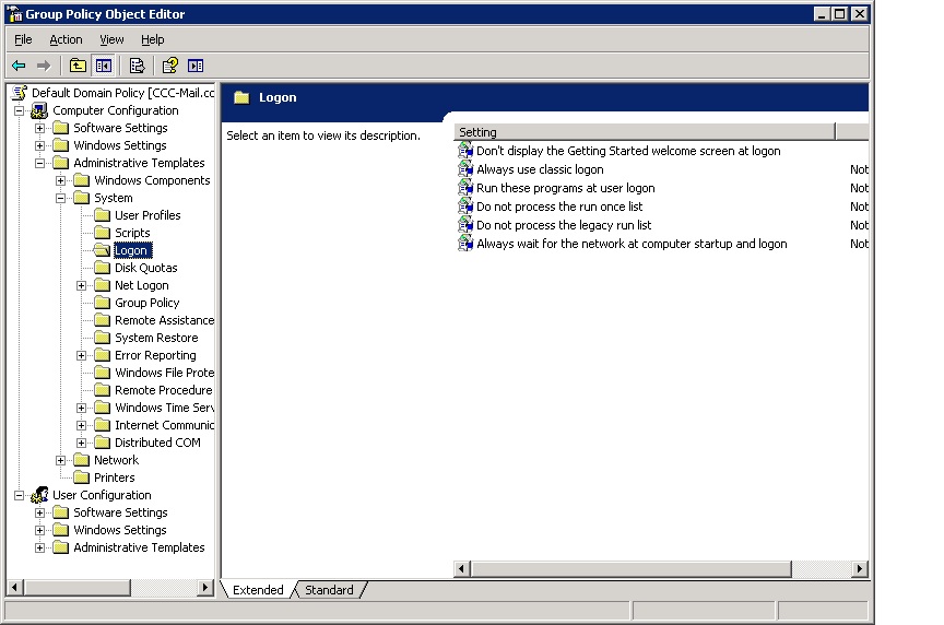

by: ComptxPosted on 2009-11-04 at 12:03:44ID: 25743327
Well, the changes that you guys are telling me "Computer Configuration -> Policies -> Administrative Templates -> System -> Logon -> Hide Entry Points for Fast User Switching" that is availiable on the local PC but not the server's domain GPO. but what i want is a way to do it over GPO, so i dont have to do it on each indidual PC...
attached is a picture of what i see on the GPO in the server.
by: gtworekPosted on 2009-11-04 at 12:06:04ID: 25743350
So as I wrote before you may add this option to your GPO with simple ADM file.
If you need some help with creating such file - just tell.

by: CAGdorfPosted on 2009-11-04 at 12:13:06ID: 25743423
comptx, try using gpmc on the Windows 7 box to manage your group policy  for the domain.

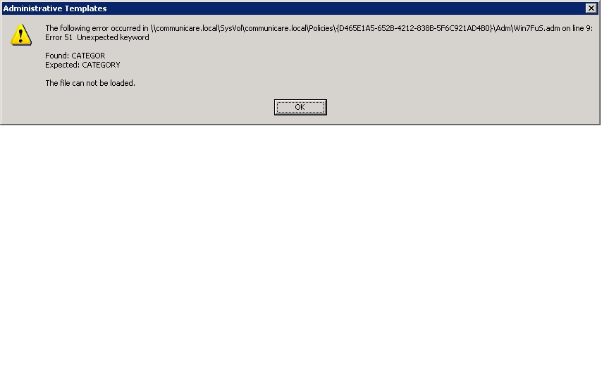

by: ComptxPosted on 2009-11-04 at 12:41:16ID: 25743665
When im adding the custom adm file i get the following error.
by: gtworekPosted on 2009-11-04 at 12:52:28ID: 25743773
Do you have "CATEGORY" keyword in your file? The error message is about typo in this word...
by: ComptxPosted on 2009-11-04 at 12:53:57ID: 25743791
I copy/pasted what you posted into the file
by: ComptxPosted on 2009-11-04 at 12:56:30ID: 25743820
from the file:

by: gtworekPosted on 2009-11-04 at 13:03:57ID: 25743905
I do not why there is CATEGOR when you pasting CATEGORY.... It's strange...
You may also try just write manually entire content. It's quite short. BTW after the HideFastUserSwitching wort there is no space before quotation mark... Let's try again in another format. Try to copy&paste again.

by: ComptxPosted on 2009-11-04 at 13:06:21ID: 25743933
Well that worked. Looked exactly the same as it was, not sure what could be the invisible difference...
