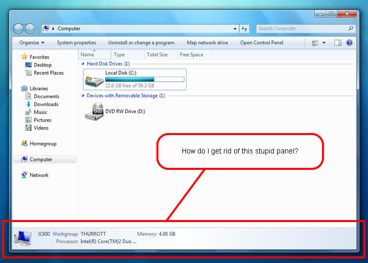

How do I hide the bottom "detail" pane in Explorer on Windows 7
Asked by: wwarby
See attached image. How do I remove this panel in Windows 7. Useful though it may be, the low resolution I am restricted to on my TV-connected media centre makes this panel an unjustifiable waste of space. In Vista you could right click and hide it, but the option is gone in Windows 7. Is it possible to hack it out somehow?

by: JBlondPosted on 2009-11-05 at 05:56:13ID: 25749436
Click on Organize in the upper left corner -> Layout > There you can disable it.
by: wwarbyPosted on 2009-11-05 at 08:40:35ID: 31650467
Urgh. So simple when you know how, and yet in an hour of Googling I couldn't find that solution anywhere. I wish they would stop moving options around between OS releases for no good reason!
Thanks for the quick solution.
