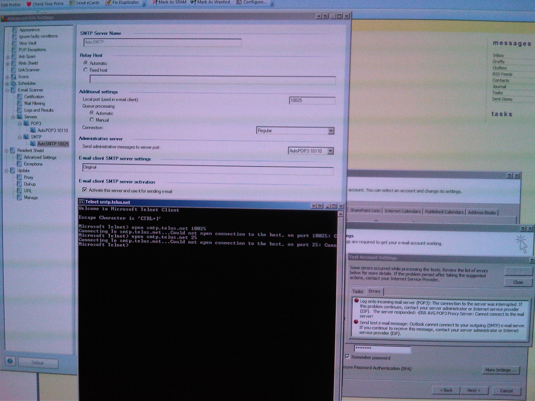

Instead I upgraded to AVG Internet Security. Here is a jpg of my results.

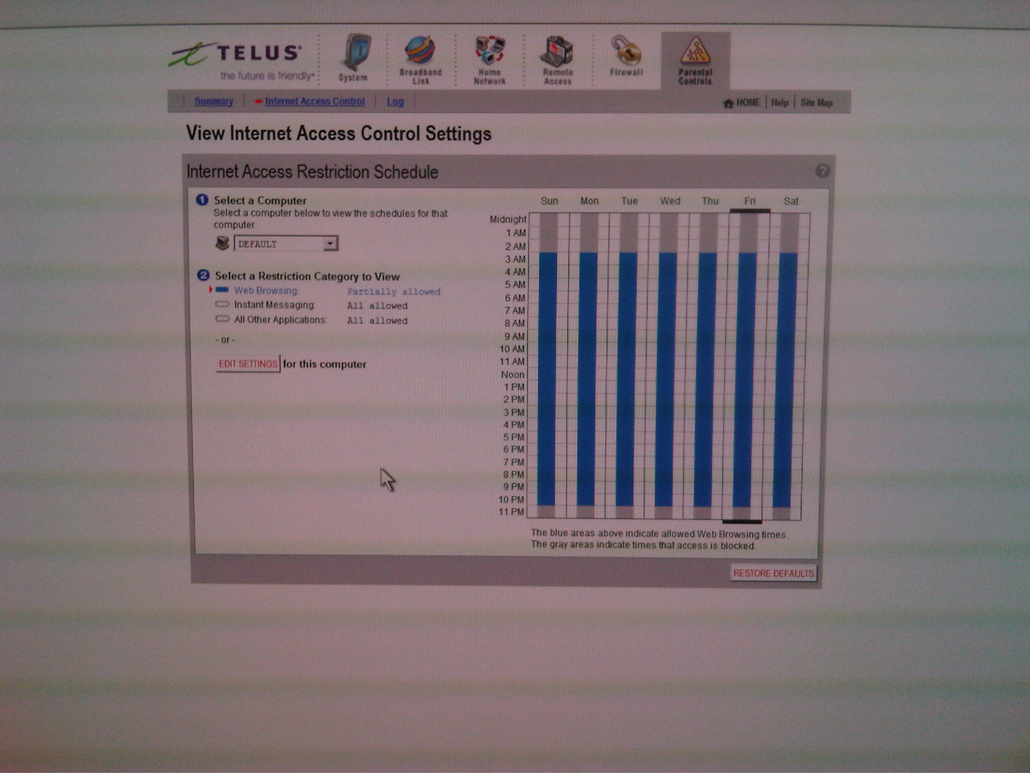

by: Scruples89Posted on 2009-09-11 at 09:02:47ID: 25310849
I have solved this problem. The Firewall set up by my 2Wire Router had a default setting for new computers auto added to the firewall. This setting permitted internet access but it blocked all other access. I am attaching a jpg of the firewal set up for default. The solution was to edit the default settings for the new ASUS system I was using. I have now reconfigured the default setting so it now permits all connections of out going applications.
