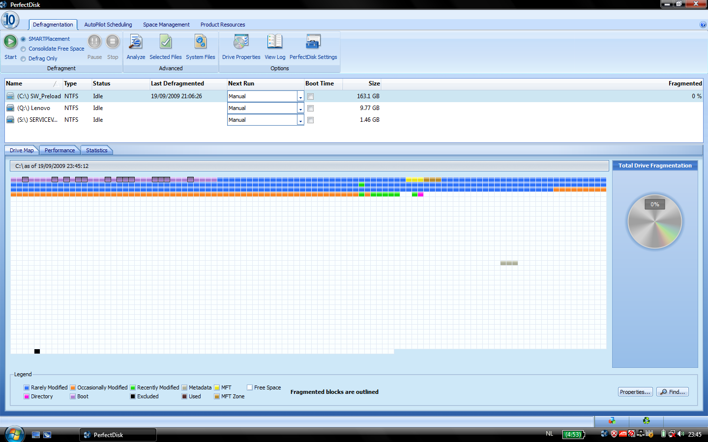

I've been trying to shrink a 285 GB Vista partition to around 40-50 GB all afternoon (currently about 18 GB is in use), but have only succeeded to shrink it to 163 GB (see Disk_Management.png).
The problem seems to be one or more files near the end of the partition that I cannot seem to move towards the beginning of the partition (see the black block in PerfectDisk_analysis.png). The 3 grey blocks in the middle of the partition are not a problem - they are apparently always in the middle of the partition, and get moved as soon as the partition is resized. The real problem is that black block - no matter what I try, I can't move it (see further for what I tried).

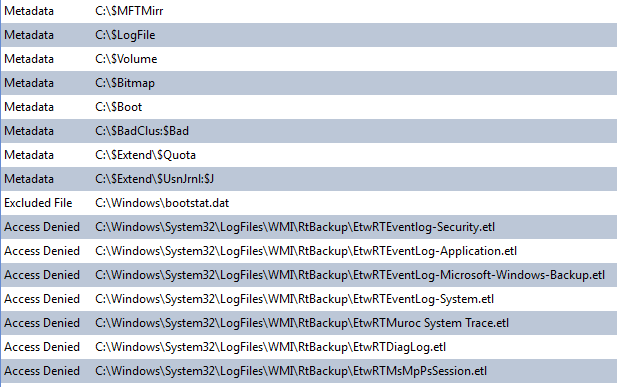

The excluded files are listed in PerfectDisk_excluded.png. I'm not sure which ones of these cause the problem ...

I tried both online and offline (during boot) defragmentation with PerfectDisk ("Consolidate Free Space" actually). It seems that the black block is properly moved when performing the defragmentation offline, but as soon as Vista is started again, the block is back where it used to be.

The problem seems to be that PerfectDisk is not allowed to move some of the files (see the excluded list in the third attached image). Most of them because they're currently in use by the OS. It can move them when running PerfectDisk offline (during boot), but as soon as Vista is started again after that, those same files are back where they were (even though PerfectDisk just moved them). Could it be that Vista insists on them being at that exact spot ?

Yes, that's what I noticed, and it seems to be due to a few meta files that are always located exactly in the middle of the partition (the 3 grey blocks in the second attached image). I know how to get around that by repeatedly resizing it, so that's not a problem for me.

The data on third image should not be the cause of the problem. I never seen such rules that make you too keep a bunch of files on one specific position of HDD so you could not move them.
