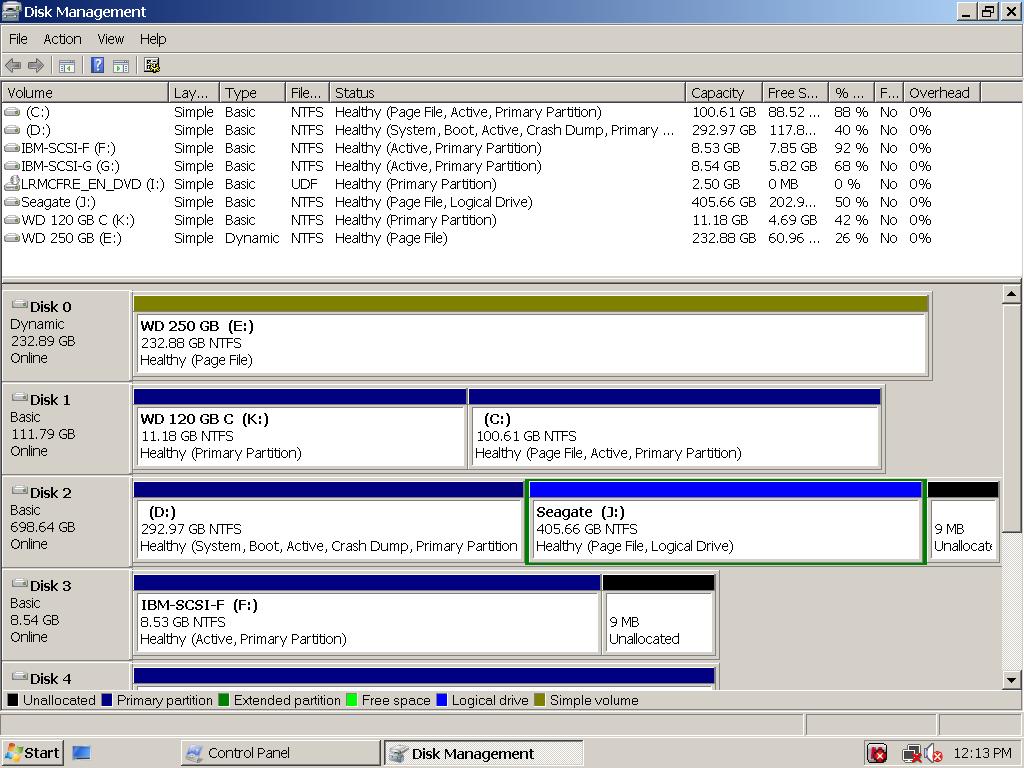

by: noxchoPosted on 2009-09-30 at 11:33:08ID: 25461839
Ok, you are in Windows even in Safe Mode and it is good. In Window enter Windows Disk Management snap-in and get a screen shot of it. Right click on My Computer - Manage - Disk Management.
Post the capture here. Do not try to repair it till I look the capture.

by: astaecPosted on 2009-10-01 at 06:57:14ID: 25468642
Here's the snapshot attachment.
 I was in Safe Mode a long time yesterday doing changes to settings, ran sfc /scannow and checked details on all the hard drives.  Uninstalled Bitlocker, disabled Pinnacle Marvin Bus in Safe Mode, display type was VGASave and in details showed tons of comnflicts on AGP controller for this Safe Mode default monitor setting.  Scheduled chkdsk for the Hard drives to run at reboot, rfeboot never happened.  Modified BIOS settings and saved to disabled the floppy drive (not there).

Why do you keep that dynamic drive? Can you disconnect it and try to boot without it?
by: noxchoPosted on 2009-10-01 at 07:05:49ID: 25468744
When you did try to perform repair was the dynamic drive connected?
Also, please check if E: volume has Bootmgr file on it.

by: noxchoPosted on 2009-10-01 at 07:53:11ID: 25469346
Verify it and I would recommend converting the dynamic drive to basic state with special tool. So you do not loose the data from it.
Do you have backup software to image this drive?

by: noxchoPosted on 2009-10-03 at 05:30:17ID: 25485021
Hello astaec, as your dynamic drive was set as first HDD in Windows Disk Management (according to your screenshot) I suspected that Windows Repair fails because you cannot install Windows onto dynamic drive or perform repairs to MBR as dynamic drive does not have it. So Windows would refuse doing changes to dynamic drive.
Removing it would help putting Bootmgr of Windows Vista to Basic HDD and possibly make it boot or narrow the problem.
