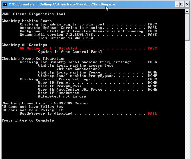

by: TJESIOLOWSKIPosted on 2009-08-11 at 08:33:20ID: 25070215
here's what I get when I run that.. I think the real issue is that this TC (or any that I re-image) is not being seen in AD...
what is the correct process for dropping a PC from AD then rejoining it without messing up SIDs, etc...??
by: dstewartjrPosted on 2009-08-11 at 08:39:32ID: 25070295
you dont seem to be getting the wsus gpo applied to this machine
run from command prompt gpupdate /force
 and then
reg query "HKLM\SOFTWARE\Policies\Microsoft\Windows\WindowsUpdate" /s
by: TJESIOLOWSKIPosted on 2009-08-11 at 08:43:58ID: 25070350
'gpupdate' is not recognized as and internal or external command, operable program or batch fille...
when searching for that reg key, it is not there...
The TC is not showing up in the default Computers OU in AD... I think that is where the issue lies.. if it's now in AD it's not going to get it's gpo....

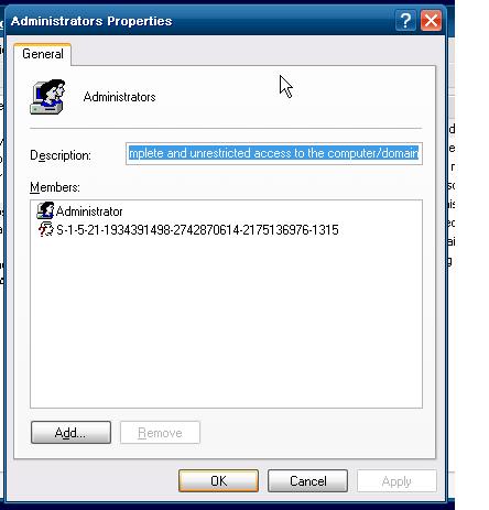

by: TJESIOLOWSKIPosted on 2009-08-11 at 11:05:25ID: 25071656
there is no such key...
also.. when I go to add a user to the local admins group it doesnt resolve the domain users name..??? something is still hosed up...
