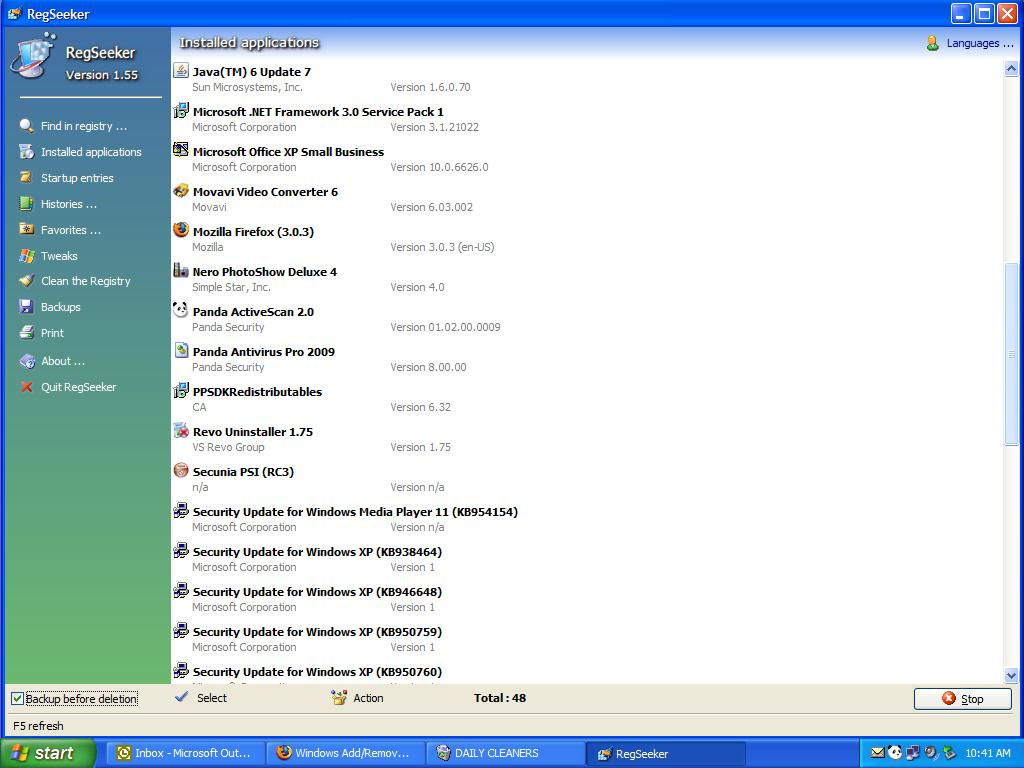

by: ginovinoPosted on 2008-10-10 at 07:06:37ID: 22687029
just an update. I am awaiting a call back from Motorola "4th" level tech support about this software. I continue to have installation problems and thus the offending item in the add/remove window.
by: GeoffSuttonPosted on 2008-10-10 at 15:46:25ID: 22691313
Wow....  I really wish I could get my hands on your computer....  I cannot imagine something being this difficult... If they can't do it, how feasible is backing up data & wiping the system?
by: ginovinoPosted on 2008-10-11 at 07:45:46ID: 22694050
i have attached 3 screen shots of the offending entry. The first as it appears in the Windows add/remove screen, the 2nd as it appears in CCleaner's install screen and the 3rd where is does NOT appear in Regseeker's installed files screen...go figure. I didn't realize the .bmp files were so large, so the 3rd file is a jpg.
by: GeoffSuttonPosted on 2008-10-11 at 09:11:57ID: 22694336
I did some research and I have a few "guesses" for you.
FACT: (this I know) Add/Remove programs pulls its data from HKEY_LOCAL_MACHINE/Software/Microsoft/Windows/Current Version/Uninstall folder in the registry.  Items are in different formats but as you go through the list and look at every item, you will find the one containing 'Motorola Crap Phono Tools' as a data item on the right.  Delete the entire folder on the left.
RegSeeker (I believe) Pulls it's data from a more in-depth HKEY_LOCAL_MACHINE/Software.  Thus it will give a more accurate representation of what is in the system since it is referencing the actual registry keys, not just what Windows thinks is installed.
CCleaner I would bet uses the same approach Add/Remove programs does.  Have you entered the registry manually and looked at each item in the Uninstall folder?
Geoff
by: ginovinoPosted on 2008-10-11 at 13:43:15ID: 22695272
GEOFFSUTTON!!!!!!
SUCCESS!!!! :):):):) HOORAH!, HAPPY NEW YEAR! BANG THE DRUMS!
I FOUND IT!
It has been lurking in the HK classes ROOTS..... Installer---Products. I was able to use REGSEEKER's "find in registry" tool the reference. How I missed it to this point in time I can't figure.
I used the built in file search tool in windows and it missed it everytime!!! God knows what else it misses.
So the problem of the erroneous add/remove entry is finally resolved and cleansed out of this machine.
I wasn't even aware that REGSEEKER had this feature. I 've come to like that little program as it appears to thoroughly clean out the old and bad registry entries very quickly. I only wish it had a help file to advise about what is safe to remove and what is not. It simply ranges the offending entries in 3 colors  RED, Orange & Green and you must decide which are safe to remove. Of course I always back up the info before purging it.
I truly want to thank you for all of your in depth help and support with this issue. Had it not been for your concise references to the registry and all the places things hide in it, I would not have remained persistent and attempt different things, moreover continuing to rifle through that morass called Windows registry!
I hope they make a sticky out of this problem and solution!
