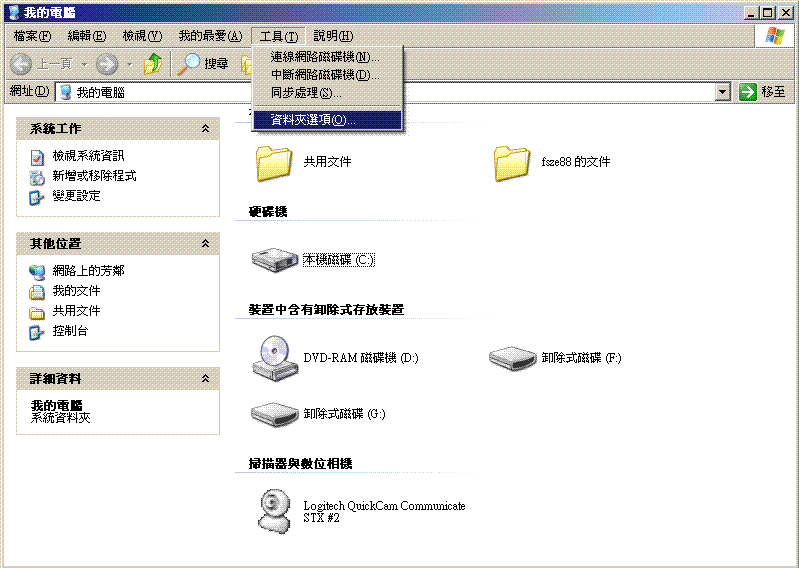

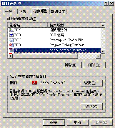

by: fsze88Posted on 2008-11-24 at 01:59:28ID: 23027208
For some users, hyperlinks to PDF files opens them with notepad?
Did you check file type of *.PDF file from
FILE EXPLORER -> TOOLS -> OPTION
FILE TYPE?
Correct it if wrong pointing to notepad

by: cbonnkirchPosted on 2008-11-25 at 08:14:45ID: 23035605
Thanks for your suggestions. removing and installing Acrobat reader does not solve the problem.
When looking at the file type assocs, i changed to Acrobat Reader for pdf. When i then click on "Restore" in that dialog, it switches back to notepad. So, notepad seems to be the "system standard" for pdf on that machine. I have done the same on my pc. There, Acrobat reader is the system standard.
How can i change this system standard? Probably in the registry, but where?

by: cbonnkirchPosted on 2008-11-29 at 00:28:09ID: 23059034
No. There is only Acrord32.exe listed here. Meanwhile i found out the following:
When you right-click a pdf file in explorer, it offers you "read" as the default action AND "open". Choosing "read" opens Acrobat reader, choosing "open" opens Notepad. On the "Open with" menu item, notepad is listed first and Acrobat Reader is listed second.
How can i correct these settings?
by: bvinsonPosted on 2008-11-29 at 09:00:21ID: 23060200
I'm on Vista, so right-click, Properties, Opens With, select Acrobat.
or
In XP Right-click, Open With, Choose Another Program (something like that, doing it from memory here) select the program and click the "Use this as default" checkbox.
