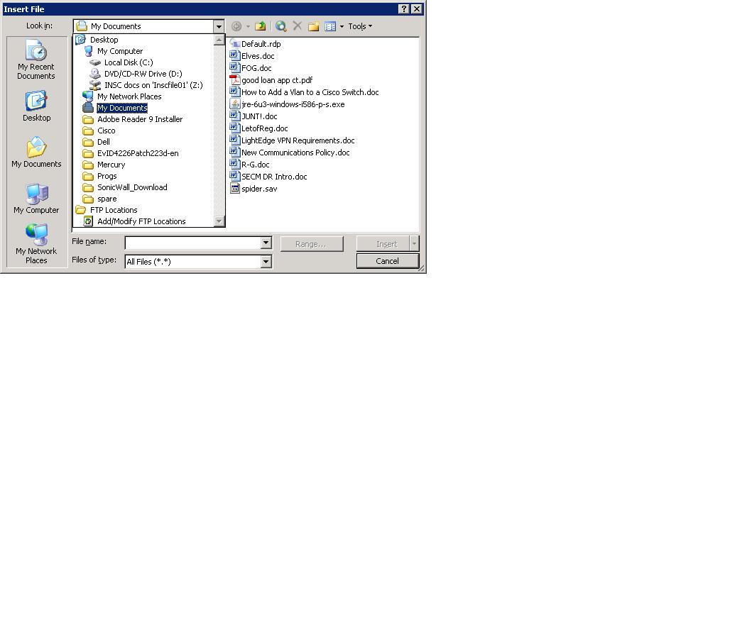

by: InnovativeNetPosted on 2009-06-25 at 12:56:23ID: 24715326
Sorry ComputerTechie, it still is having issues after the TCP/IP patch was run, but a new symptom occured.
If the user tries to search for a file, and uses the drop down box at the top (pic below) it takes anywhere from 3-60 seconds to have it populate. Still looking for a solutions, any ideas are welcome.
by: dbruntonPosted on 2009-06-25 at 13:26:56ID: 24715665
See if you can monitor this user's network connections.
That TCP/IP message seems to indicate that it is trying to connect to a large number of computers.  Try and see what it is doing.
