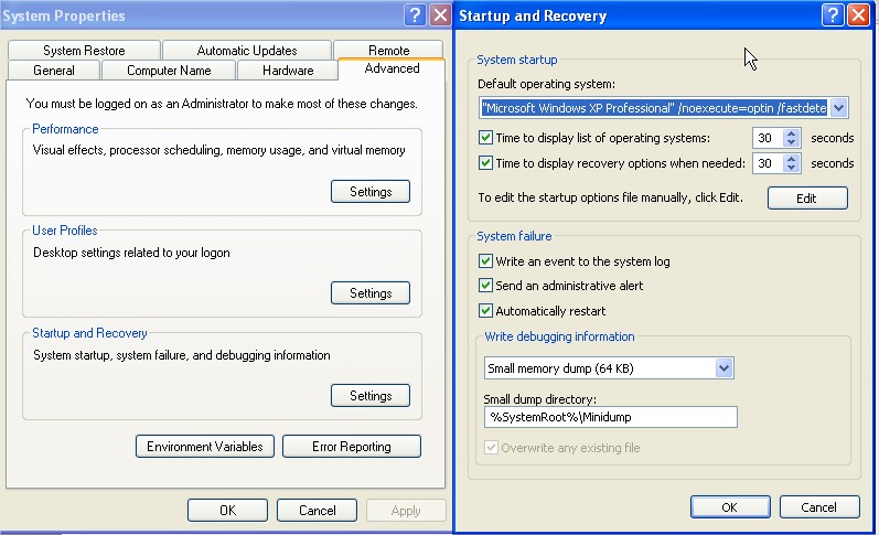

by: KnightsmanPosted on 2009-07-28 at 06:08:52ID: 24960236
Also might be a drivers issue.  Right click on your My Computer, click on Properties, and then go to the advanced tab.  Click on settings under startup and recovery and disable automatically restart.
should cause the "blue screen of death"  Write down the error that comes up, should help us troubleshoot some more.

by: noxchoPosted on 2009-07-28 at 07:32:18ID: 24961057
Look for minidumps and post them here. Rebooting means that your system got BSOD. In right click on My Computer - Properties - Advanced - Startup and Recovery uncheck the restart automatically. And since then you will be able to get BSOD and message on it.
Minidump will give us chance to track the problem causing dll or driver.

by: noxchoPosted on 2009-07-31 at 11:51:30ID: 24991392
Good. Now look for minidump and post it here. Here is the steps of minidump finding: http://www.pchell.com/support/minidumps.shtml
You will need to change the extension of the file to picture one to attach it here.
