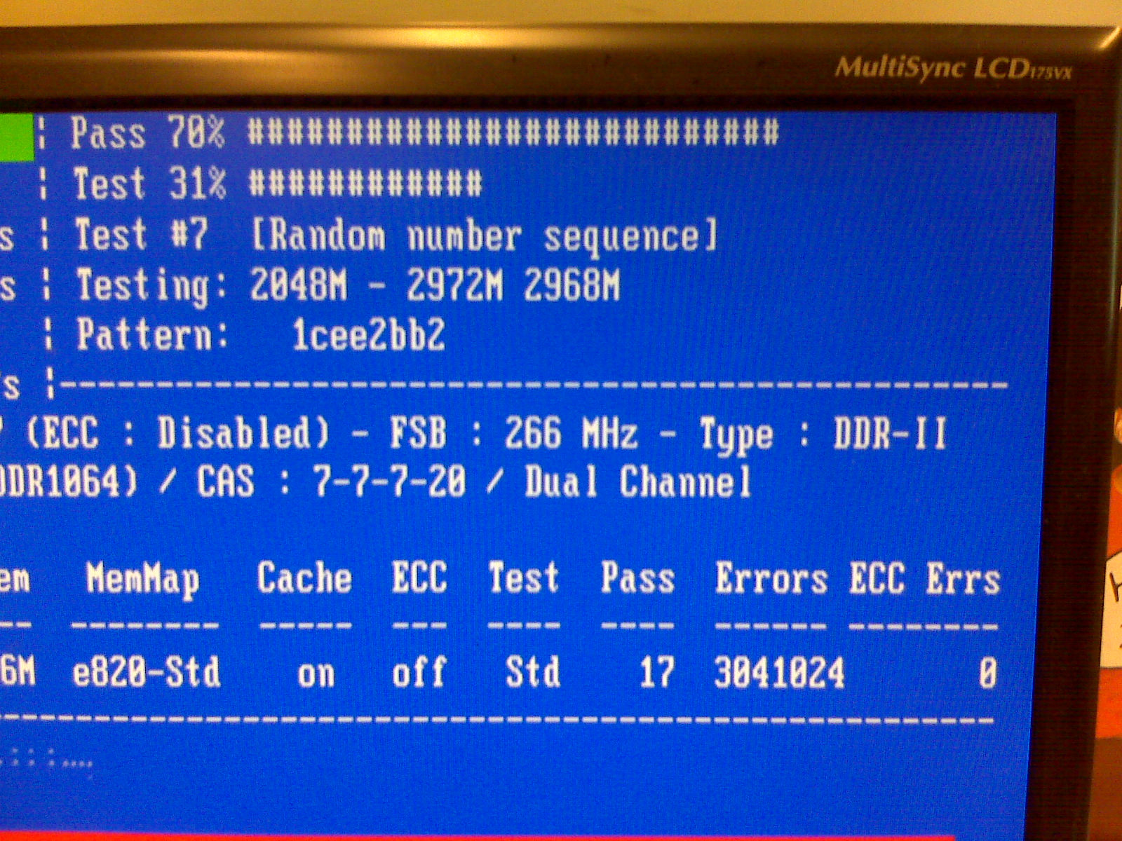

Hello Everybody,
I've attached the minidump for this BSOD and additional event log info. I'm looking for an accurate explanation for this BSOD.
Thank you,
Max

by: nobusPosted on 2009-08-12 at 00:10:19ID: 25076284
note that it can be just bad ram - so test it with memtest86+ from www.memtest.org
by: awawadaPosted on 2009-08-12 at 02:05:55ID: 25076848
all drivers up to date?
by: SlavyanPosted on 2009-08-12 at 05:37:58ID: 31614484
Correct nobus. MemTest86+ returned errors after running overnight.
Thank you,
Max
by: SlavyanPosted on 2009-08-12 at 05:39:37ID: 25078042
Here is a screenshot of the errors returned by MemTest86+
Max
by: nobusPosted on 2009-08-12 at 07:43:54ID: 25079238
tx for the feedback !
