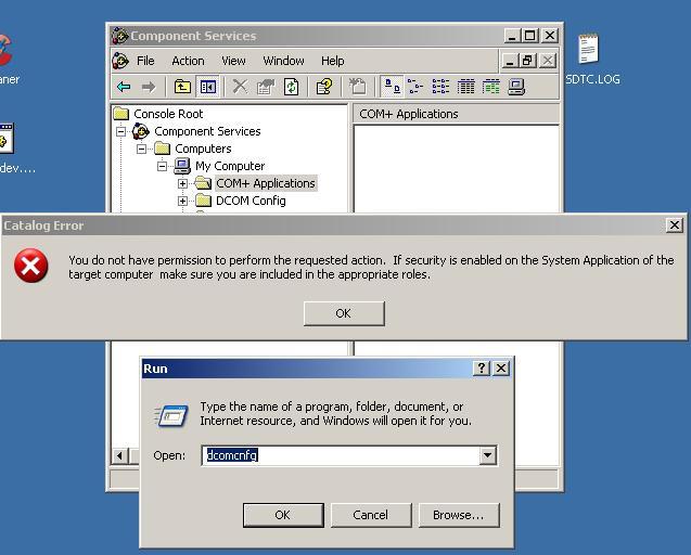

by: GST-GRIDTECHPosted on 2009-09-05 at 19:22:15ID: 25268554
I WAS able to run SFC /purgecache and  /scannow.
/scannow to a Very long time and didn't seem to do anything, So I Guess that Should means the
"WINDOWS FILE PROTECTION" scan was ok...
after some additional research,...I ALSO ran the "SECURITY CONFIGURATION & ANALYSIS" SNAP-IN.
This DID rest the permissions on the %SYSTEMROOT, which was my initial problem.
I have SCANNED for viruses/Malware a few times in between, can't find any new ones..
THE MAJOR PROBLEM I'M HAVING NOW IS GEETING OUT OF WHATEVER STATE THE VIRUS LEFT THE PC IN.
IF I GOT TO LOCAL USERS & GROUPS,
I CAN'T SEE THE PROPERTIES FOR  OR MAKE ANY CHANGES TO THE "ADMINISTRATORS" GROUP.
ANYONE KNOW WHAT WOULD LOOK ME OUT OF THAT??????? OR HOW I COULKD FIX???
I THINK MY PROBLEM "MAY"BE MOSTLY WITH THE REGISTRY....????????
THANK YOU ALL FOR YOUR COMMENTS, SUGGESTIONS AND ASSISTANCE...

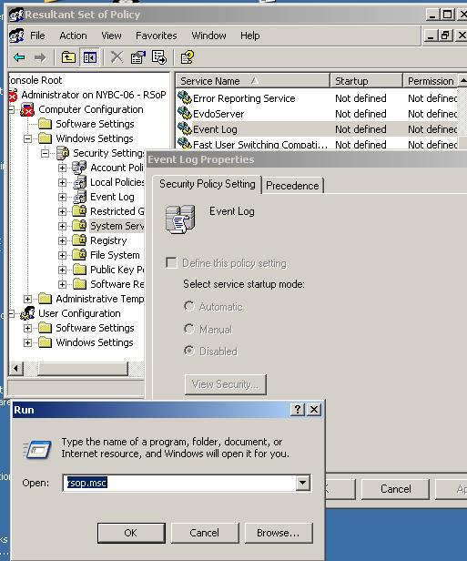

by: GST-GRIDTECHPosted on 2009-09-05 at 20:17:48ID: 25268647
..... ALSO, I AM STILL UNABLE TO START OR STOP ANY SERVICES......
also noticed that the list of services in the "EXTENDED" tab is blocked out .
I CAN see the list of services in the"STANDARD" tab..  having problesm NOW, but can send a "PIC" of the services window/s to show you what I mean and how  the services window NOW looks like..
also,while doing some additional reseach, I came across some one mentioning "SC.exe"
ANYONE familiar with using sc.exe to reset security and logins on any service...??
THANK YOU.....

I'M STARTING TO THINK MY PROBLEM MAY NOW BE RELATED TO
EITHER A PROBLEM WITH COM+ (dcomcnfg.msc) IMAGE ATTACHED
OR POSSIBLY WITH RESULTANT SET OF PROPERTIES (rsop.msc) IMAGE ATTCHED.
I, OF COURSE, AM TOTALY UNABLE TO TROUBLESHOOT THOSE TYPES OF ISSUSES,
JUST BEYOND ME...
\\NYBC.LOCAL DOES REFER TO A MS-SBSERVER WHICH THIS PC LOGS ONTO..
THANK YOU,,,,
wuau.adm
Location - "\\nybc.local\SysVol\nybc.local\Policies\{FB93D2B5-1C6D-4E08-8F4D-CC93650BCC07}\Adm\wuau.adm"
Error - The network location cannot be reached. For information about network troubleshooting, see Windows Hsystem.adm
Location - "\\nybc.local\SysVol\nybc.local\Policies\{FB93D2B5-1C6D-4E08-8F4D-CC93650BCC07}\Adm\system.adm"
Error - The network location cannot be reached. For information about network troubleshooting, see Windows Hconf.adm
Location - "\\nybc.local\SysVol\nybc.local\Policies\{BF338408-C0CD-413B-B5CA-CA771AAEB028}\Adm\conf.adm"
Error - The network location cannot be reached. For information about network troubleshooting, see Windows Hwmplayer.adm
Location - "\\nybc.local\SysVol\nybc.local\Policies\{FB93D2B5-1C6D-4E08-8F4D-CC93650BCC07}\Adm\wmplayer.adm"
Error - The network location cannot be reached. For information about network troubleshooting, see Windows Hinetres.adm
Location - "\\nybc.local\SysVol\nybc.local\Policies\{BF338408-C0CD-413B-B5CA-CA771AAEB028}\Adm\inetres.adm"
