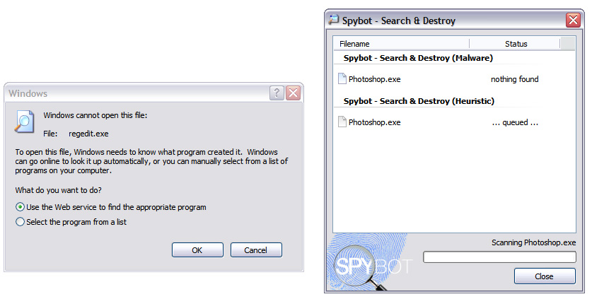

my windows xp pro does not work when I try to run programs and click on shortcuts.
The icons do not come up either.
If I do run it, Spybot comes up to do a scan, does not find anything.
I can see the files in Program files but only firefox and photoshop work at the moment.
I tried to search the net for a solution but I cant even get into msconfig, regedit or HJT
I cant even change the registry with a .reg file.
Is there anything I can do?
Please help, this PC is at work and I have also tried doing a repair install and still nothing.
During the repair install the graphics card drivers ask to be installed and then it said run32.dll not found and gave me an option of what program to run it with.
Thanks in advance

How did you run Spybot?
by: jcimarronPosted on 2009-09-10 at 15:26:09ID: 25305153
cataleptic_state--If all the "programs and shortcuts" are for .exe files, you may have lost the association for .exe files.
http://www.dougknox.com/xp/file_assoc.htm  Notice the NOTE.
http://filext.com/faq/broken_exe_association.php
by: orangutangPosted on 2009-09-10 at 22:07:48ID: 25306807
Also, see if you can run regedit by copying it somewhere and renaming the extension to .cmd or .bat or .scr
by: cataleptic_statePosted on 2009-09-11 at 01:52:26ID: 25307626
Ok,
I've tried sfc/ scannow does not work.
Tried http://filext.com/faq/broken_exe_association.php
The folder options -> file types does not allow me to apply the new extention "EXE" just has a close button.
I am not clear on the edit registry manually option.
Also I managed to get CC Cleaner working by renaming it to .cmd AND regedit
But regedit wont allow me to import a backup of the registery I made a month ago.
It says some of the keys are open by the system or other processes.
I've tried this in safe mode and normal. Still the same problem.
I will give manual regedit a try.
by: cataleptic_statePosted on 2009-09-11 at 02:52:35ID: 31627162
Brilliant! I did what the manual edit said and it worked. Everything reappeared as normal.
