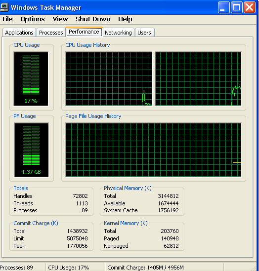

by: Netman66Posted on 2009-10-31 at 09:11:22ID: 25710272
You can then look at the performance metrics in Task Manager to see what processes are either consuming lots of CPU cycle or processes that are leaking memory (under Memory you'll see enormous amounts of RAM being consumed and climbing but not declining).
Post anything you think looks odd.

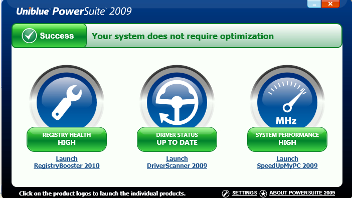

by: Camilleri_DavidPosted on 2009-11-02 at 05:45:44ID: 25719170
Although there are a lot of processes, these processes do not take a lot from the CPU. My CPU at any time has 95% of its power free.
by: Netman66Posted on 2009-11-02 at 05:57:49ID: 25719267
If you have used the Registry Cleaner component of that product then that explains the problem.
There isn't a single Registry Cleaner/Optimizer out there that doesn't cause problems when it starts deleting what it believes to be orphaned entries.
I've hosed perfectly fine installations when testing them out - and the systems exhibit exactly what you descibe; slow opening of anything and a ton of disk activity.
If you chose the option of backing up the original copy of the Registry before you ran it, you might want to consider a roll-back.
by: Camilleri_DavidPosted on 2009-11-02 at 12:18:17ID: 25723296
I did not save the Registry. Shall System Restore do the trick? I do not thing so.
So how about formatting the HDD after extensive back-up?
It is unbelievable that Registry Cleaners cause more problems than they solve. I forked out a lot of money to buy these so called 'Cleaners'.
What shall I do? Which software which can optimize the registry without harming it?
I am really perplexed a aghast.
