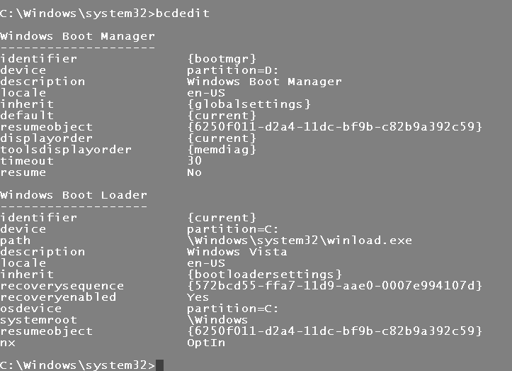

Thanks very much for your response.
I typed bcdedit into the command prompt and I've attached a screenshot of the output.
What do I do next? thanks.

I hate to say it, but your bcdedit command returned perfectly normal and expected results, the problem therefore lies elsewhere. I've heard great things about EasyBCD in regards to easy editing of the bcd, go grab yourself a copy from http://neosmart.net/dl.php

Load up Vista with USB stick installed, open up a Command Prompt as administrator and type "bcdedit". XP and back used boot.ini to determine the boot order, vista changed that by using the bcd to manage faster booting.
