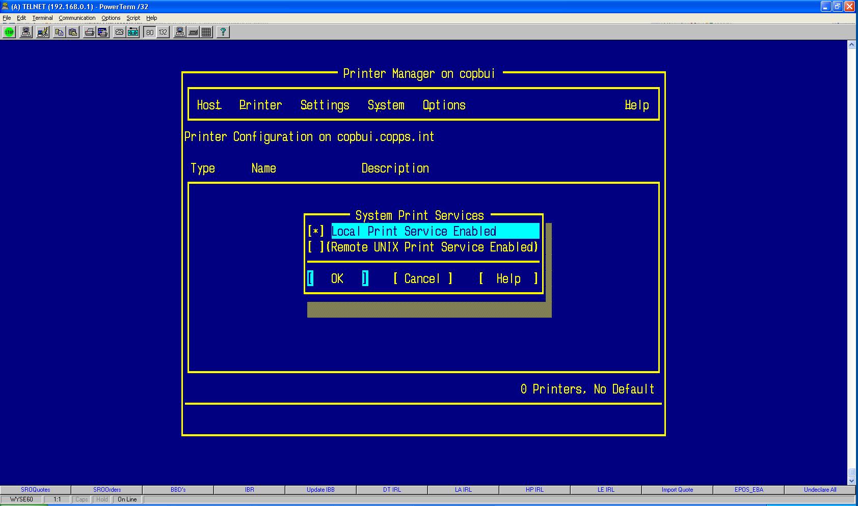

Asked by: coppsbuildall
I would like to send a print job from the shell to a network printer. We are currently using this script to print to serial line printers and it works great. However recently we have started adding print servers to the printers in an effort to get rid of the serial port server.
I have attached the script below. The files that it reads in just has a six digit number in it ... and it is incremented after every print.
Any advice on how to modify the script to print to a network print server would be greatly appreciated.
Thanks!

by: already_usedPosted on 2009-10-30 at 16:47:13ID: 25707522
Are you adding the network printers as lpr/lpd (remote printers)
Change the script so that the line that actually copies the printfile to the device,( line 379?) is replaced by
"lp -d $printer -c -s $file"
Be sure to use the -c option to prevent the first print queue from deleting the file before the second queue has printed it.
This script looks like it supports about 6 printers.
by: mikelfritzPosted on 2009-10-31 at 11:52:52ID: 25711003
You would need to add some logic to handle the existing serial printers until they disappear.
One way could be to define a print command for each device.
For a tty or non-network spool:
printcmd="cat form$newfile >> $printer"
For network printers:
printcmd="cat form$newfile | lp -d $printer"
Or you could set up all remaining serial printers as spools and then change the script to only use lp on line 379 and change the printer selection steps to define spool name instead of device file.
by: coppsbuildallPosted on 2009-10-31 at 12:23:58ID: 25711148
Thanks for the suggestions ... the printers are sitting on the network ... there is very few of them. What I was hoping to do is define the network printers like the serial ones are defined below ... that way when the name of the printer is typed in than it will know it is a network printer and not a serial printer. Can you modify the script to suit?
hpofficei 192.168.2.206
laofficei 192.168.4.206
Keeping in mind that I have no scripting experience ... is it easy to modify the script to work appropriately?
by: mikelfritzPosted on 2009-11-01 at 04:37:59ID: 25713519
The modified script below is one way.  It has a new variable named ptype - if ptype=s (for serial) it will act as it always did.  If ptype!=s then it will consider it a spool.  For demo purposes I changed the ttya03 (and location 01) printer to hpofficei spooled printer.  The actual print command now checks to see if ptype=s, if it does it uses cat, else it uses lp.
Mike

I am trying to add the printer ... however after going into printers > printer manager  > print > add remote > then i am not able to click on anything. I tried enter, arrows, everything I could think of. The only thing I can do is press ESC to go back to the previous selection.
by: mikelfritzPosted on 2009-11-04 at 18:14:20ID: 25746194
You can't type anything once in there?  I'm doing it character based so there's no clicking on anything.  The tab key is essential, it's a horrid interface.
by: mikelfritzPosted on 2009-11-04 at 18:17:55ID: 25746210
Possibly (not advisable) from a root prompt - "mkdev rlp" and install...
I think this is the one that will break if done more than once.
by: coppsbuildallPosted on 2009-11-04 at 18:19:23ID: 25746216
actually i can click on the "add local" ... really click on it. I have also tried to use the keyboard ... no go. I can get into the Add Local but not the Add Remote. Is there something that I need to enable first to access this?
by: coppsbuildallPosted on 2009-11-04 at 18:21:46ID: 25746227
Is this not something that is done during the OS install? I think that if this could cause issues that I will contact our POS first before I run this.
by: mikelfritzPosted on 2009-11-04 at 18:30:30ID: 25746262
Not really.  Any issues it creates are fixable, just more stuff to mess with.  Maybe try under print manager -> system -> print services -> enable remote and local.
