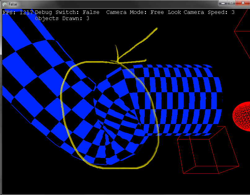

I am generating the main points on which my CatmullRom spline is based as follows:
            waypoint_Current += new Vector3(Game1.Random.Next(-8, 8), Game1.Random.Next(-5, 25), -Game1.Random.Next(5, 15));
If I have a lofted polygon created from a parallel transport frame that follows the spline then the tube created overlaps itself as shown on the picture attached.  This gets worse as I increase the radius of the tube/lofted polygon.
How do I combat this?
I had a thought that it might be necessary to generate random points that have a distance between them that is longer than the radius of the tube but then I wasn't sure how to ensure that the interpolated spline points would be far enough apart to prevent the overlap from happening.
Can anyone help?
Thank you.
Radius overlaps when turning
