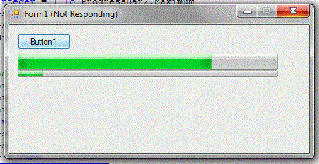

by: wht1986Posted on 2009-08-25 at 11:47:41ID: 25180825
Ive always used 2 progress bars, one positioned just above the other.  The top one would be the progress of phases (1,2,3,4), and the bottom one is the progress during a particular phase.
I just added some sleep calls to slow the loops down in the code, but you should get the idea where I am going
        ProgressBar1.Step = 1
        ProgressBar2.Step = 1
        'do something for phase 1
        ProgressBar1.Value = 1
        Threading.Thread.Sleep(1000)
        'do something for phase 2
        ProgressBar1.Value = 2
        'phase 3 has to loop through 30 items
        ProgressBar1.Value = 3
        ProgressBar2.Value = 0
        ProgressBar2.Maximum = 30
        For i As Integer = 1 To ProgressBar2.Maximum
            ProgressBar2.Value = i
            ProgressBar2.Refresh()
            Threading.Thread.Sleep(100)
        Next
        'phase 4 has to loop through 20 items
        ProgressBar1.Value = 4
        ProgressBar2.Maximum = 20
        Next
        'All Done
        ProgressBar1.Value = 0
