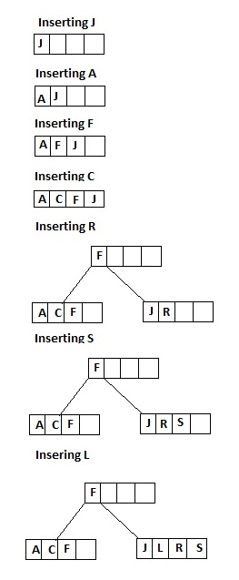

if I want to insert J, A, F, C, R, S, and L, into a b+ tree in that order, is this the way to do it?

What do you call a B+ tree ? If I understand correctly your example, it is a two-way linked chain of 5 values array, used to quickly implement a sorted list of values.
It seems complicated though, why not use a two way linked chain of simple values ? Why is F in two arrays when you insert R ?

That's a reasonable way of doing it.
When you insert R you can split the nodes up so that F is in the right one, but that's just arbitrary.  It would result in arity 2, 3, and 2 in 3 bottom nodes instead of 3 and 4 in 2 bottom nodes, but it's just as valid.  Unless for some reason you're required to implement a B+ tree using a specific algorithm (like for a class), this doesn't really matter.

and what does it look like when L and F are deleted?
will it be A and C on the bottom left J on the root and J,R, and S on the bottom right? Am I getting this correctly?

Why does F show up twice?  In a real implementation, you'd include a data pointer with EVERY key value, not just on leaf node key values, so you would only see F in there one time.
When A and C are deleted, the ideal implementation would detect that the leaf node is less than half-full, and it will combine the data and merge it back into the root node.

well, isn't that how a b+ tree works.. it duplicates the key in certain parts of the tree? at least there's one person saying it's correct and one person saying it's not correct....
and I am deleting L and F not A and C

BillBach:  You could consider this to be a B+-tree implementation of a set instead of a map, so there are no values in the terminal nodes.
You have the bottom row correct.  But notice that F is in the root in your example tree.  This implies that a key in an internal node is equal to to the maximal key in its corresponding subtree.  So the root node should contain C, not J.

so R as a root would work?

No.  Think about the lookup algorithm for a B+tree.
You look at the keys in the root node, and find the first one that is >= the key you are looking up.  Then you descend into the corresponding subtree and recursively do the same thing until you reach a terminal node (where you search for an exact key match).  If all of the keys in an internal node are less than the key you are searching for, then you descend into the rightmost subtree.
In the top node you need to have information that steers the search into the correct subtree.  So you store the maximal key in the corresponding subtree for each internal node.  The maximal key in the left subtree is C, so you keep C in the first key slot of the root node.

so it will be will it be A and C on the bottom left C on the root and J,R, and S on the bottom right? if I am understanding your instruction correctly

yes.
