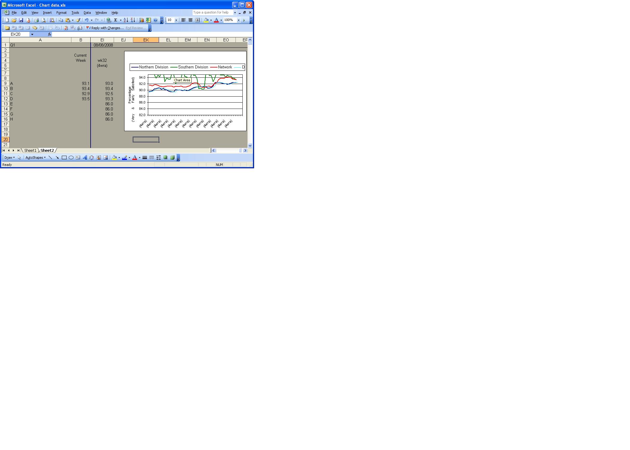

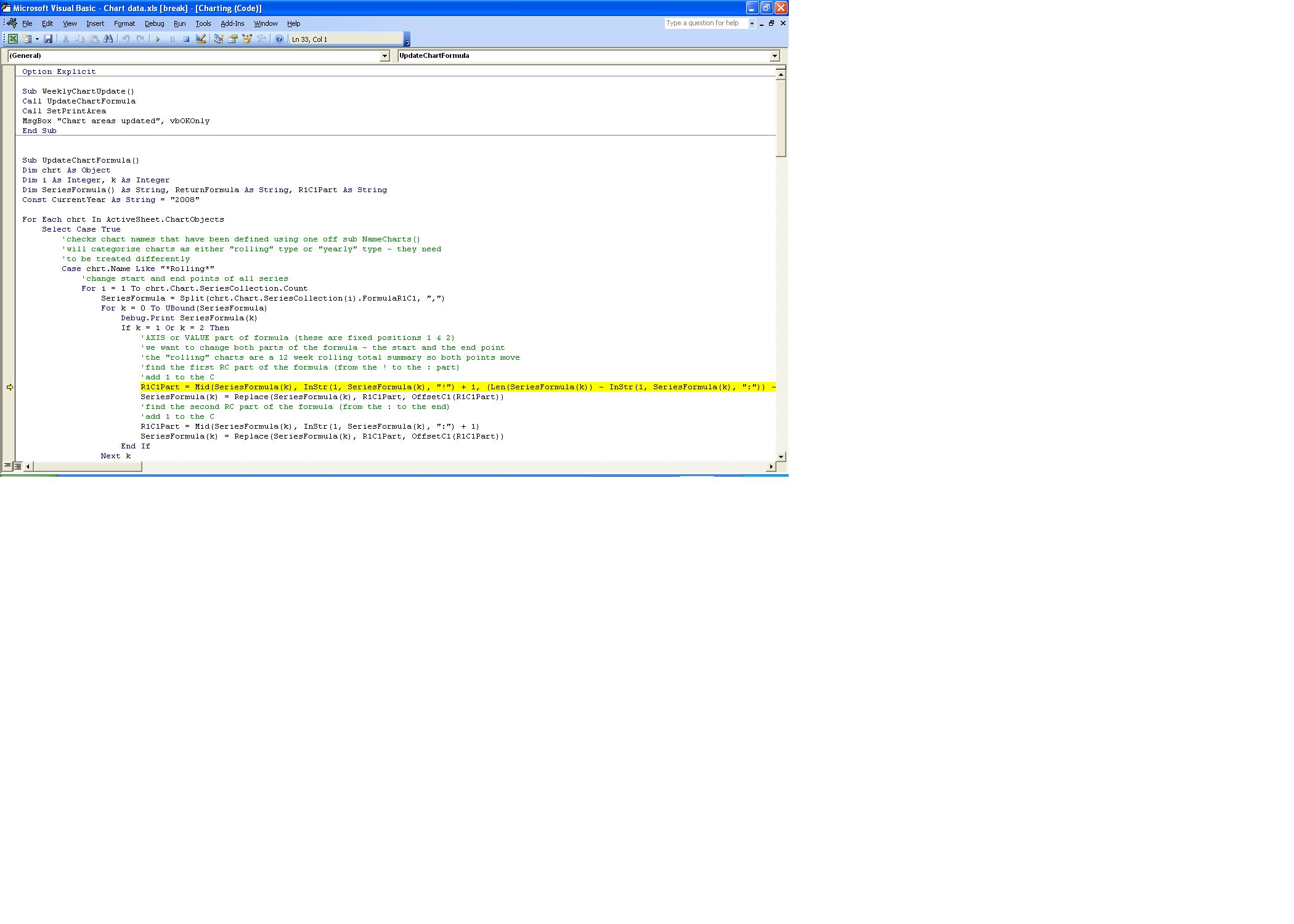

Thank you for your reply , I have attached a screenshot of the file (error.jpg) and screen shot of the chart I am amending by adding a 4th series(4th series.jpg). I have copied over a chart from sheet 1 into sheet 2, and (without adding the 4th series and only updating sheet reference) the macro(UpdateChartFormula) works perfectly. However, once I have added in the 4th additional series (E, F, G or H) I get the error attached for some reason.
I have included the Excel file as well; I just cant seem to understand why this is failing. Thought it may be easier to see this way instead of the above code.

There appears to be something slightly awry with your workbook. If you add a new series to the chart through the wizard, the SERIES formula does not contain the axis label data. As a result, your parsing fails because you are trying to use Mid and Instr on a zero length string. If you alter the SERIES formula on the chart so that it includes the label data, then the code runs fine. I would strongly suggest you copy your data to a new workbook and recreate the charts just to be on the safe side!
Regards,
Rory
PS Attached version has a 4th data series added with formula amended manually.
