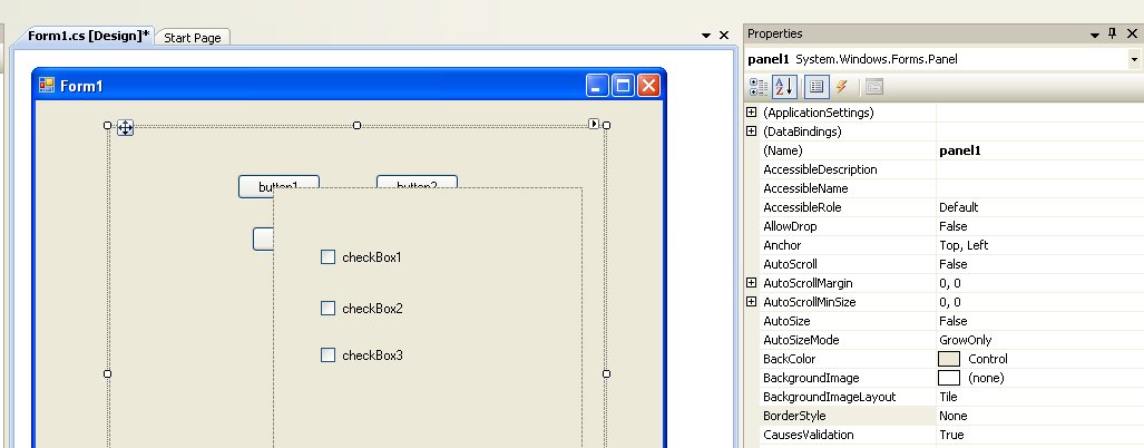

Asked by: finance_teacher
If you put 2 panels on top of each other
do you have to move the top panel
in order to edit the bottom panel
or is there a better way since
"Bring to Front" does not show
all the CONTROLS ?

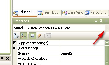

by: ee_nitinkPosted on 2009-08-16 at 20:13:29ID: 25111451
Offcoarse there is a better way.Here it is :
As shown in the attached picture, select the correct control from the properties dropdown. The control that is selected in the properties dropdown, is the one which is selected in the Design view for editing.
Hope that answers your question.

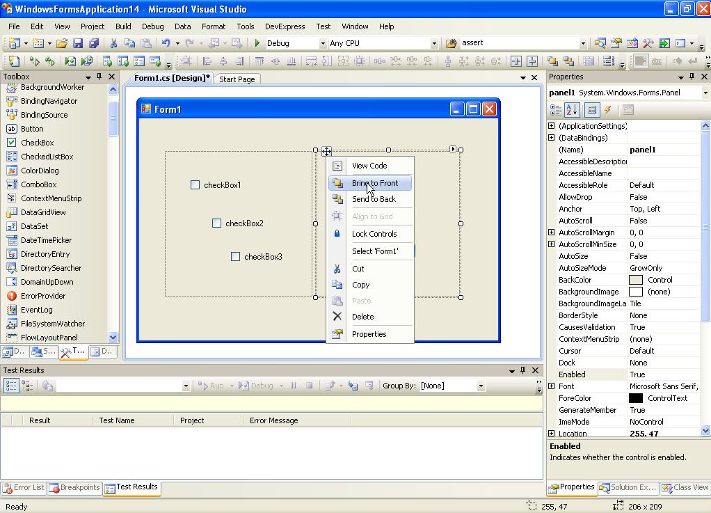

by: finance_teacherPosted on 2009-08-17 at 05:52:00ID: 25113787
ee_nitink, I tried your solution, but my attached still shows "Panel2" hidding some "Panel1" controls when "Panel1" is selected.
How did you get it to work ?

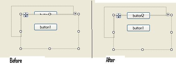

by: ee_nitinkPosted on 2009-08-17 at 07:32:08ID: 25114752
Now I get your problem. :)
Well I cant,though, imagine a reason why you want to do that.
Just for the sake of editing, I think,
          rather than bringing all controls of Panel1 and Panel1 to front, try taking Panel2  back.
