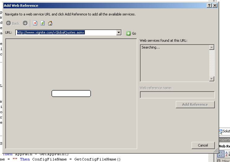

How do i reference an ASMX web service in Visual Studio 2008  project?
If I right click the Web References folder in my project, I get a nice dialog window where I type in my path to the asmx web service.
I type in the full URI:   http://www.thewebservicehostdomain.com/thefolder/theservice.asmx
It searches and searches indefinitely.
If I type it into a browser, the typical web service shows up nicely with all the methods, so the service works just fine.
Is it no longer possible to connect to asmx services any more with a VS2008 application?
I have a funny feeling it is trying to look for a .svc extension - is there any way to force VS2008 to create an asmx web reference?
(note: not using WCF or any of that newer - and incredibly buggy- MS technology as it could take years to convert existing apps - I have days to figure this out)

There is no advanced button, I get the typical tabbed pages [.Net], [Com], [Projects], [Browse],[Recent].
This is a winforms project, not a web project - why that option is not there.
 I do have an option to add a Web Reference, but, like I stated above, it never finds any references to ASMX files, even if the complete URI is typed in.

by: bd9000Posted on 2009-08-19 at 10:49:32ID: 25135344
unfortunately, like i said, this is not a WCF web service, but a SOAP 1.1 web service I am trying to connect to.  The problem is with Visual Studio's "Add Web Reference" dialog box (looks like a bug in SP1).
If you point it to say: http://www.xignite.com/xGlobalQuotes.asmx
nothing happens - nada!  it grinds away forever and never "discovers" the services.
VS2005 finds web services every time, to there is either a bug in VS2008, or MS no longer supports non-WCF web services.
Please see the attached screen capture.  I've turned the firewall off to eliminate that as a problem.
by: paololabePosted on 2009-08-20 at 01:07:16ID: 25140151
If you can't see "add service reference" I suppose your target framework is .NET 2.0 (changing to 3.5 you will see add service reference, but I think you need .Net 2.0)
I've tried to add a reference to asmx ws and seems ok.
try for exaple a ws from http://www.webservicex.net
opening http://www.xignite.com/xGlobalQuotes.asmx appear a web page not a web service, so it's normal that vs can't register
i've read support page of that web site and you have to call the web service throgh:
http://www.xignite.com/xGlobalQuotes.asmx?WSDL
for me it works
by: bd9000Posted on 2009-08-21 at 10:26:32ID: 31617457
That was it. Thanks!
