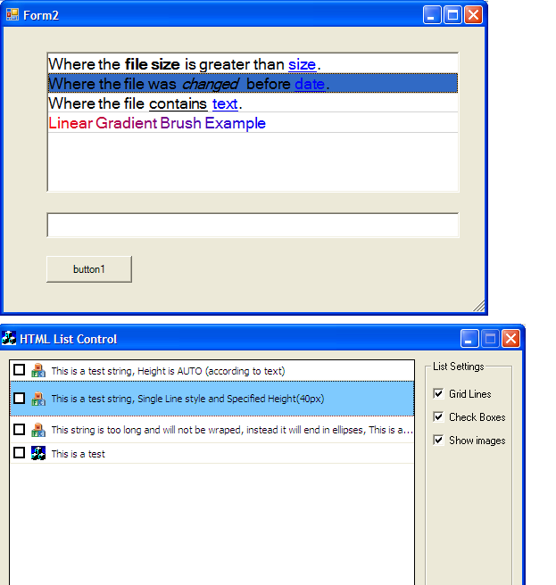

Hi all,
All selection color in windows default is  blue how to change this color like image I attached below, ex: change it to red ,...

by: kaylanreilorPosted on 2008-03-13 at 00:07:27ID: 21113919
Here I have chosen a color that is not convenient but it is to have a visual effect...
Don't forget to add reference on System.Drawing and the statement :
using System.Drawing;
        private void listBox1_SelectedIndexChanged(object sender, EventArgs e)
            int i = listBox1.SelectedIndex;
            Rectangle rc = listBox1.GetItemRectangle(i);
            SolidBrush myBrush = new SolidBrush(Color.Beige);
            Graphics g = Graphics.FromHwnd(listBox1.Handle);
            g.FillRectangle(myBrush, rc);
by: minhvcPosted on 2008-03-13 at 00:23:34ID: 31439297
Thanks for your help.
