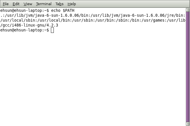

by: jkrPosted on 2008-05-20 at 10:26:00ID: 21608293
Open a shell and type
echo $PATH
Check whether the changes are in effect.
by: EhsunPosted on 2008-05-20 at 11:11:21ID: 21608694
My $PATH is like this but Eclipse still can not run the C++ files
Look at the attached file.

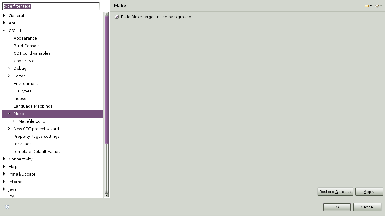

Thanks for your complete explanation, but I should say that in the Window > Preferences > C/C++ > Make > I don't have any option for making new Make Project or I can not find it! you can check my screen shot below:
by: EhsunPosted on 2008-05-21 at 05:09:19ID: 31459651
I found it! ;)
Seems like you have a different version than me ;) But I assume you found where to set it :)
