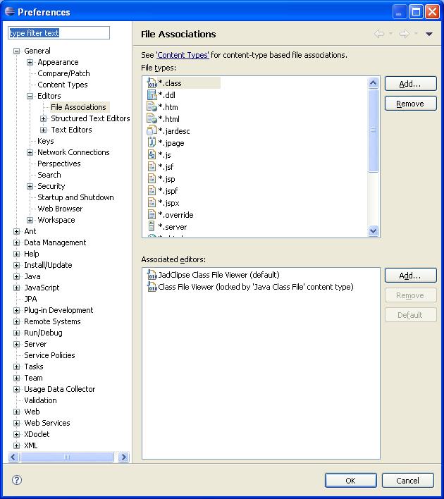

So I tried to configure it with the plugin for eclipse 3.3 (although I have eclipse 3.4) using the steps mentioned in the link.
Now when I click on the .class file from within eclipse, it still opens the file in the eclipse viewer even though Jad viewer is set as the default .class file viewer. Please refer to the attached JPG file

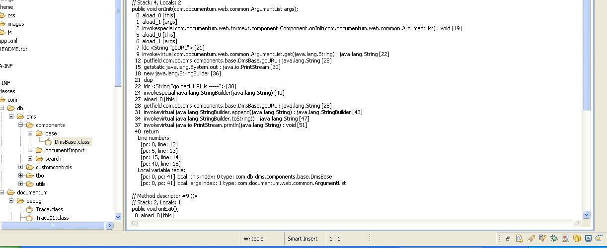

It does show an icon for the class file but still class files open in default Eclipse viewer
Please have a look at the screenshot
