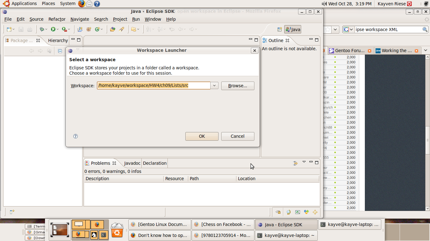

Are you sure you want to open the XML file?
Did you pick the option previously to use a workspace as the default workspace, but you are now needing to open a different workspace?
From inside Eclipse, choose File | Switch Workspace | Other, then paste  "/home/kayve/workspace" in the workspace box without the quotes.
While still on the "select a workspace" dialog, there is a twisty you can expand to copy settings if you so choose.
If that is not what you need, please clarify what you are trying to do.

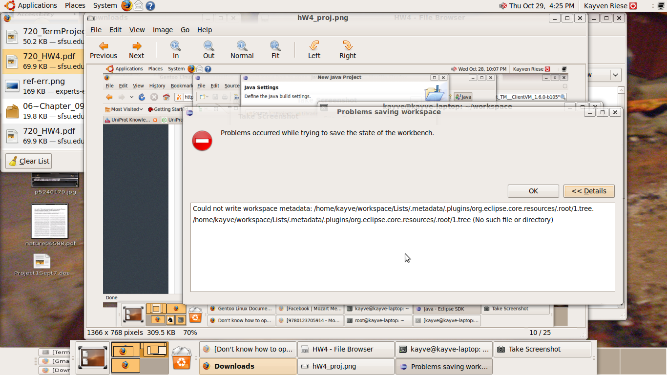

by: kayveyPosted on 2009-10-28 at 15:26:56ID: 25688957

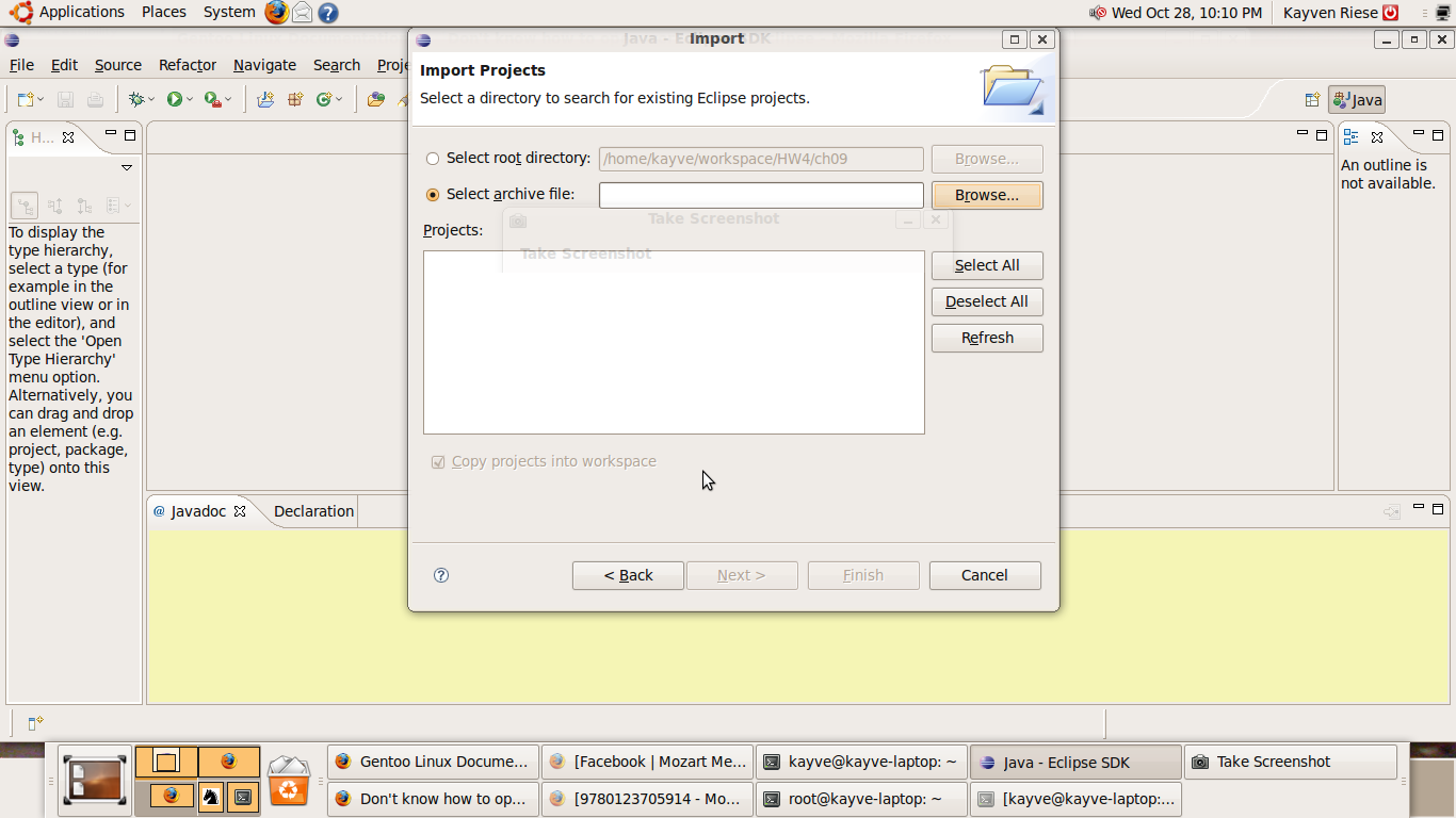

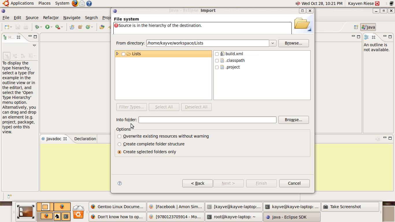

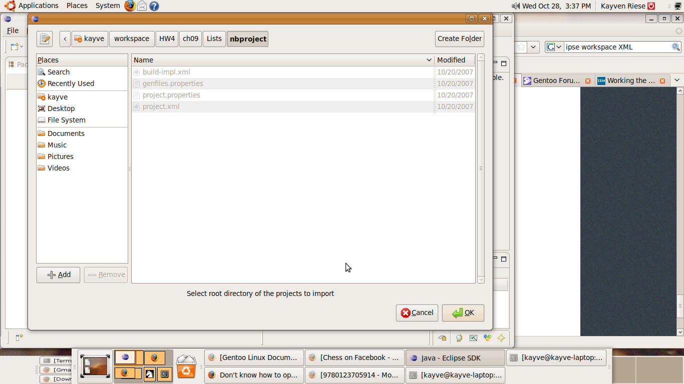

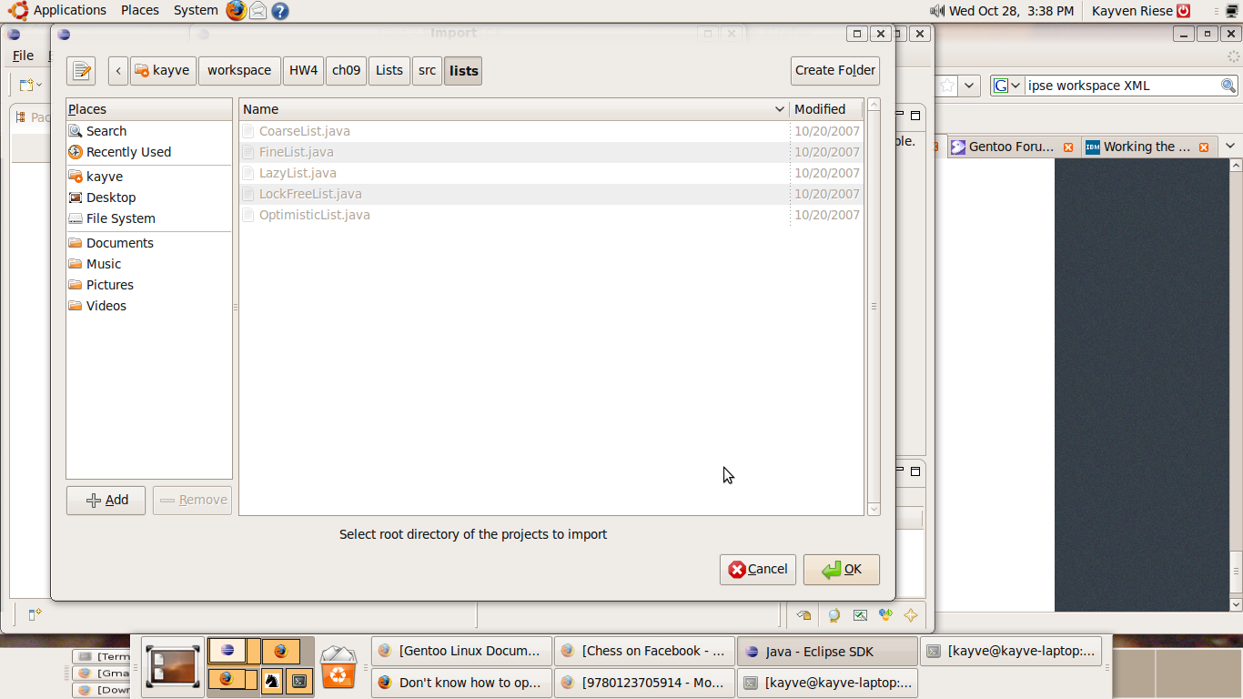

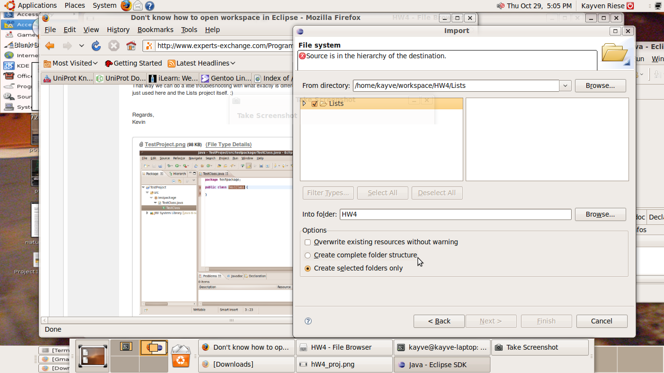

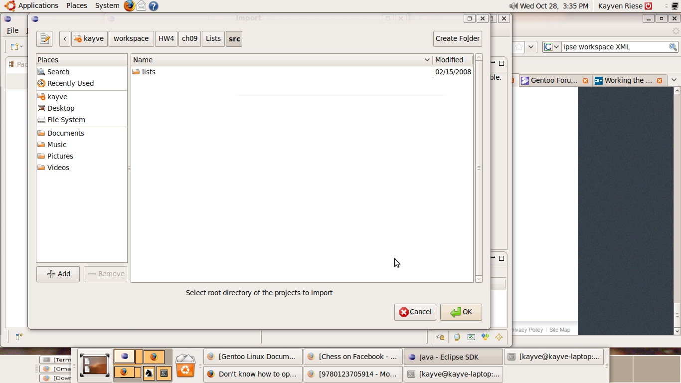

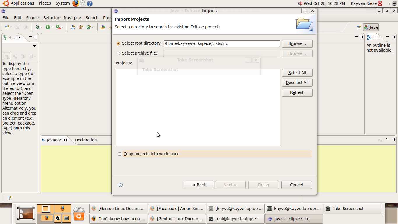

by: mrjoltcolaPosted on 2009-10-28 at 15:32:10ID: 25688989
If it is a project, you will likely need to import the project.
Since I don't know what your instructor gave you, I can only guess. Eclipse does not require the project to be inside the workspace. It can be anywhere. Just open Eclipse, select a workspace (it can be any empty directory, or that high level workspace directory, then do "import"
File -> Import -> General -> Existing Projects into Workspace
Select root directory -> Browse -> Ok -> You should see the project listed

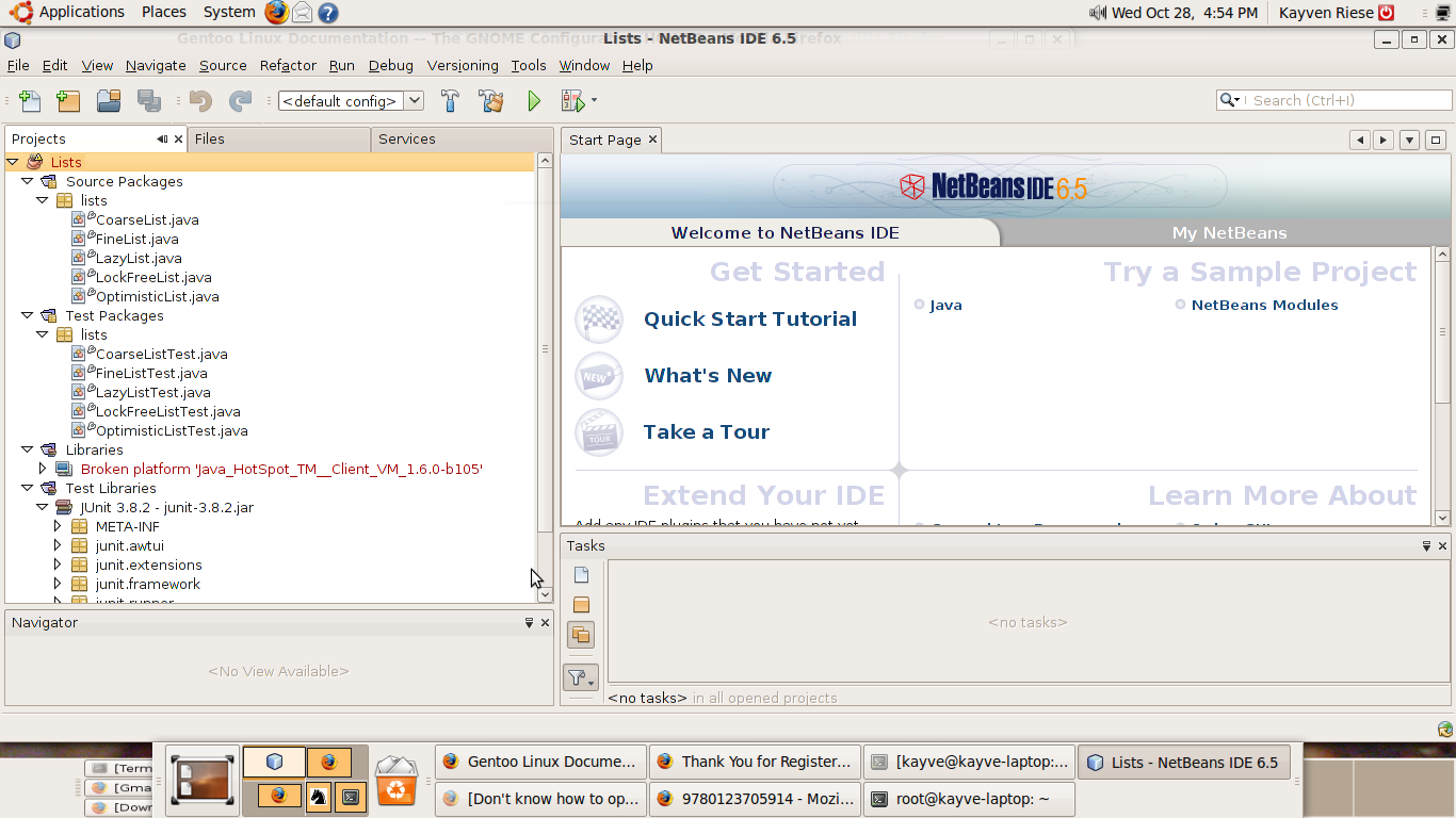

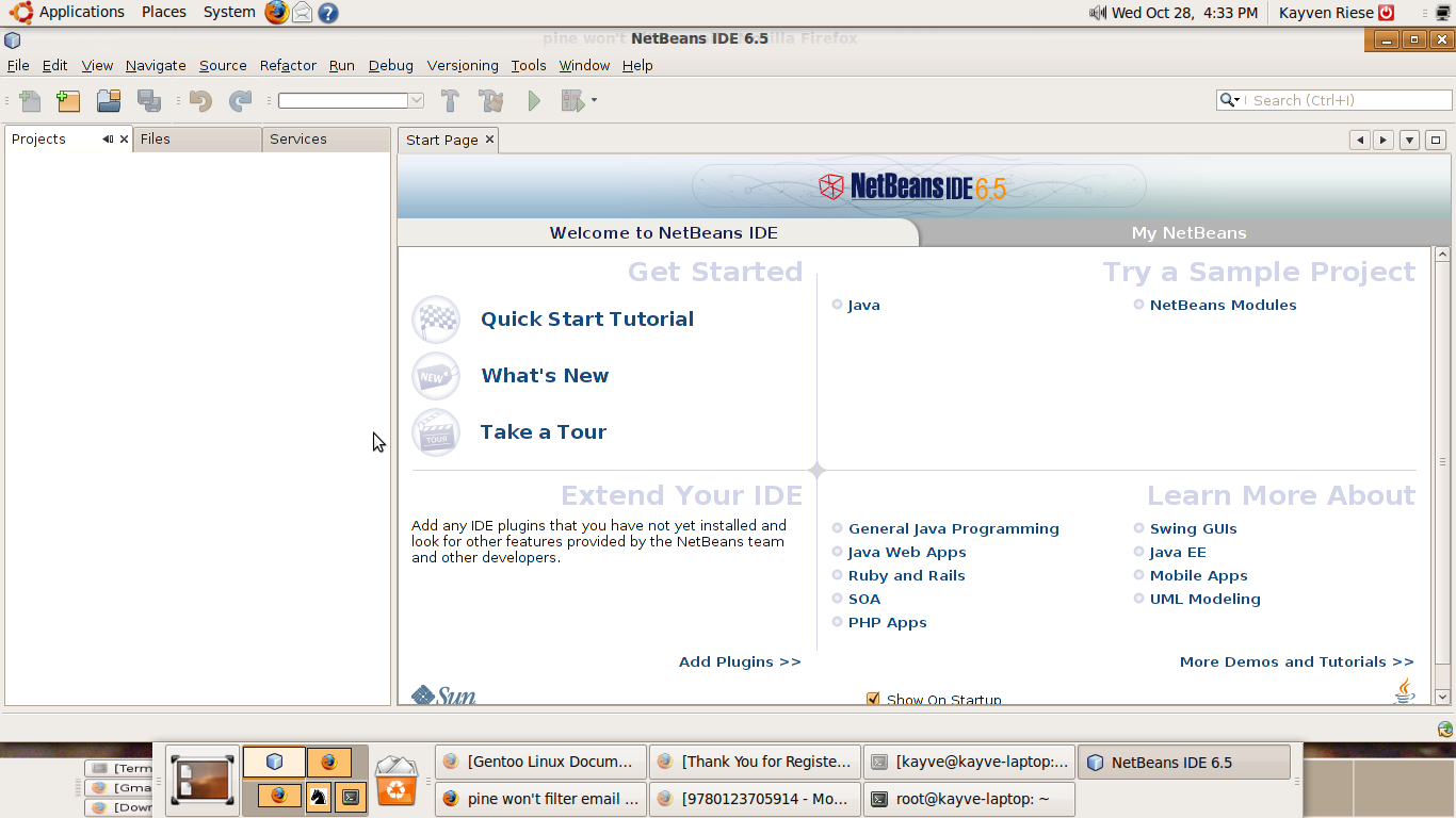

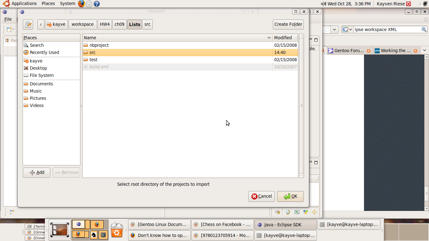

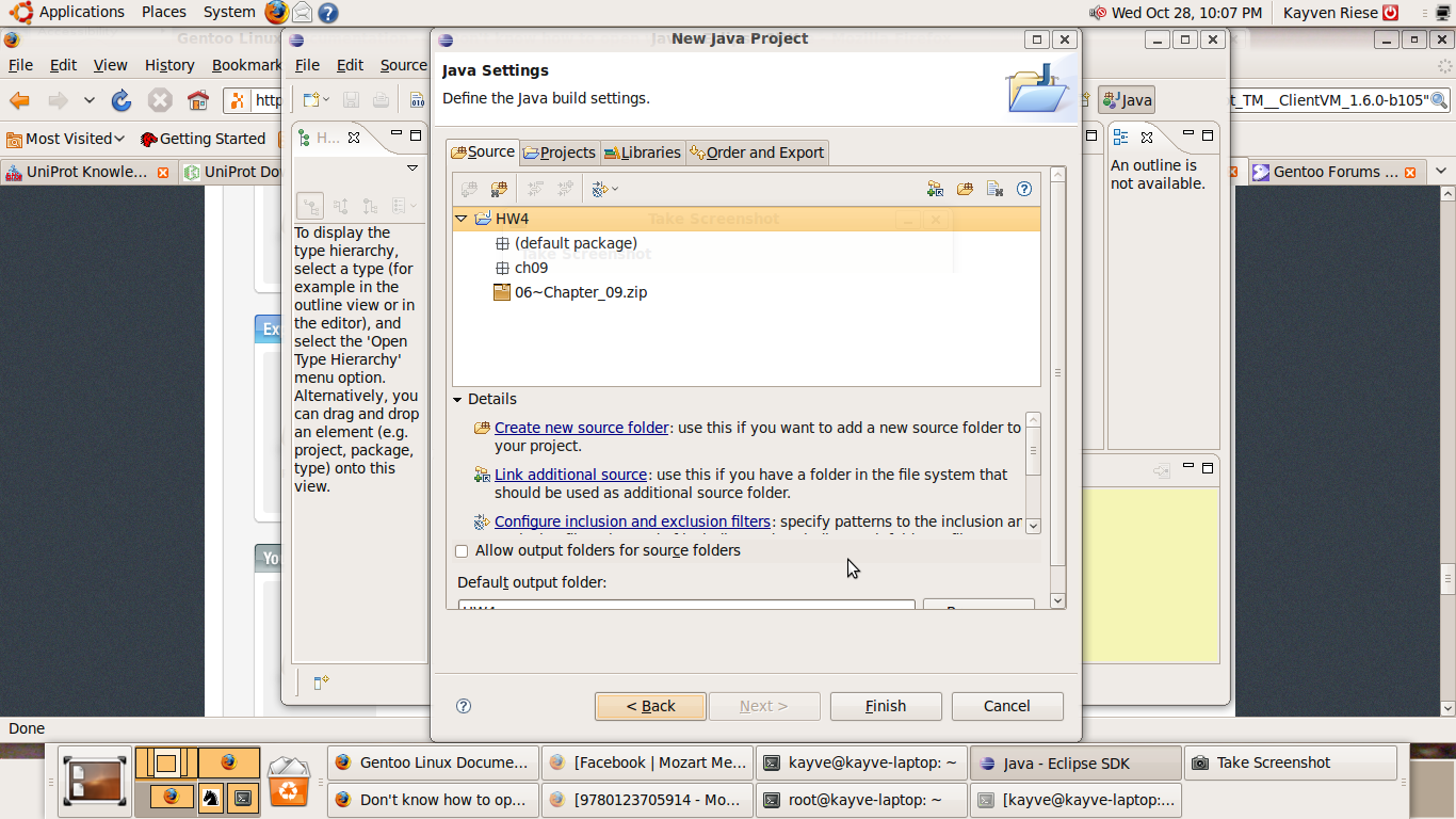

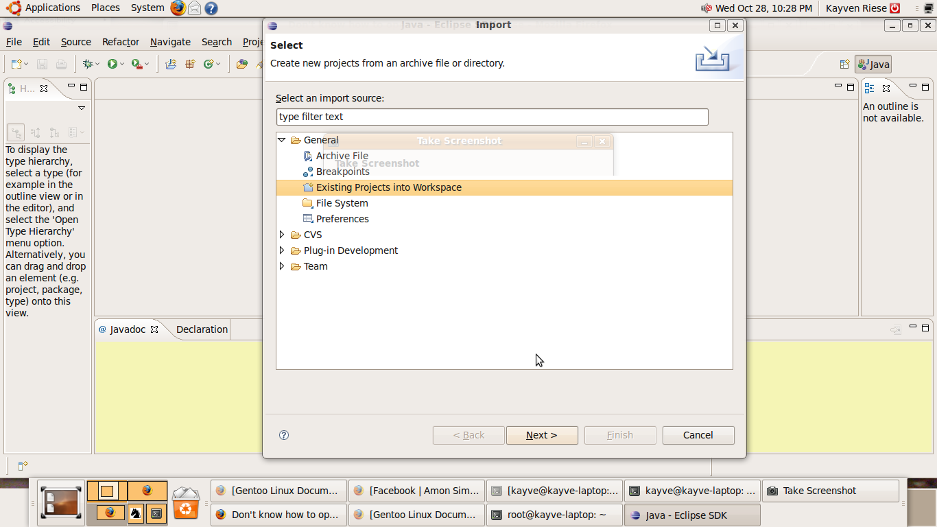

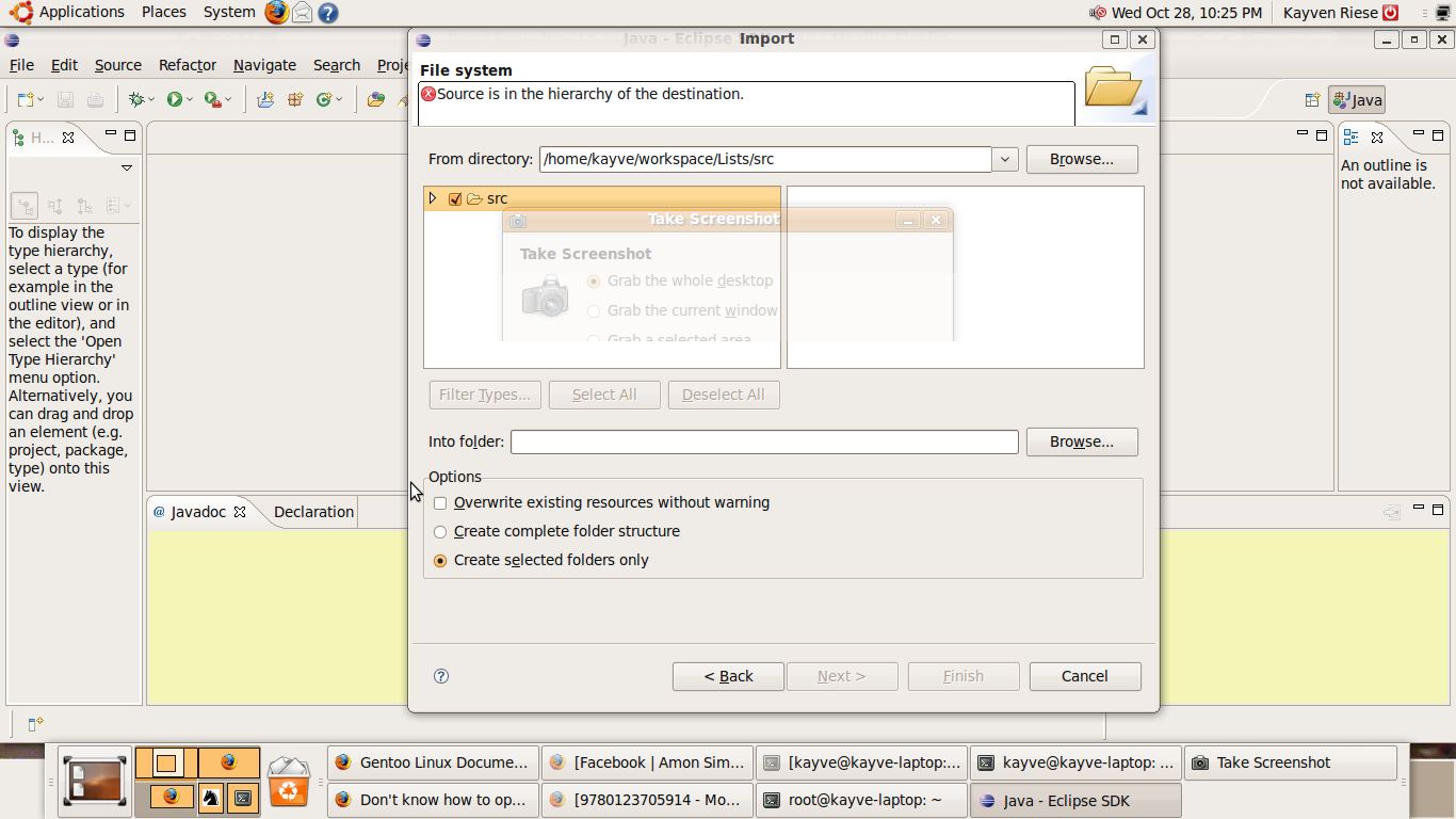

by: kayveyPosted on 2009-10-28 at 15:40:42ID: 25689041
you DO know what I was given I have shown the files plainly in the listing using "ls"
I will give you screenshots now.
by: mrjoltcolaPosted on 2009-10-28 at 15:48:38ID: 25689099
Try following my instructions.
If this is the level of patience you have, you are in for a lot of frustration.
by: kayveyPosted on 2009-10-28 at 15:49:59ID: 25689109
My screenshots shows that I plainly have done so.

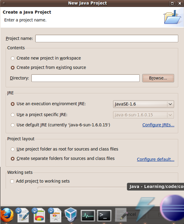

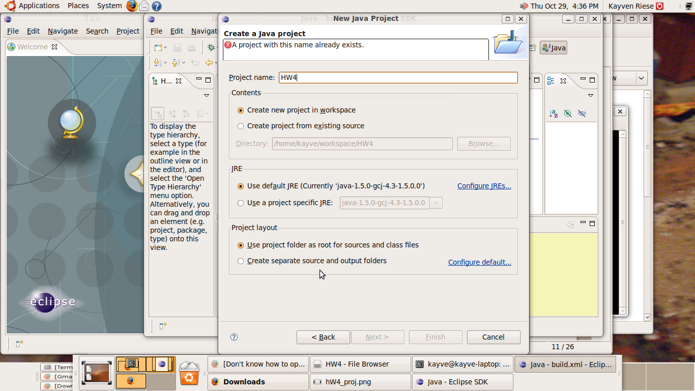

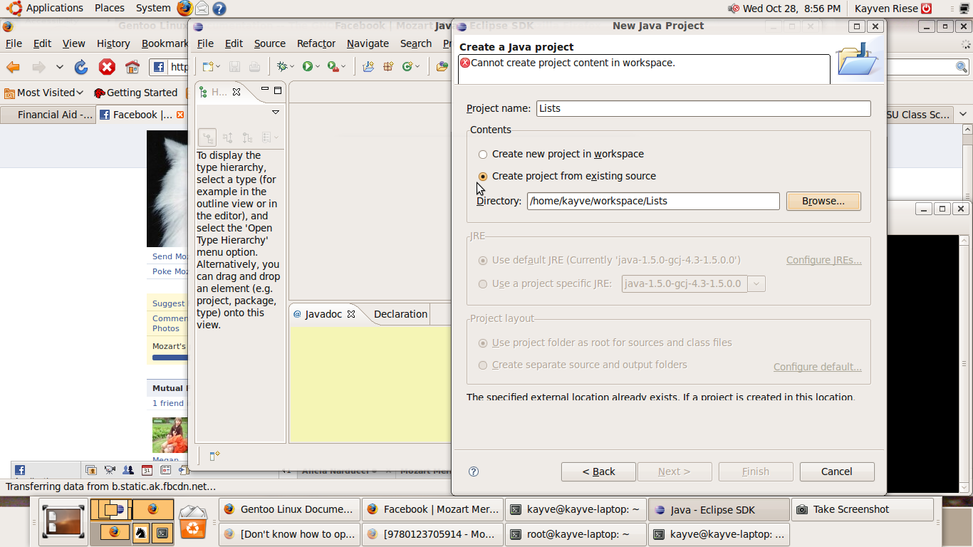

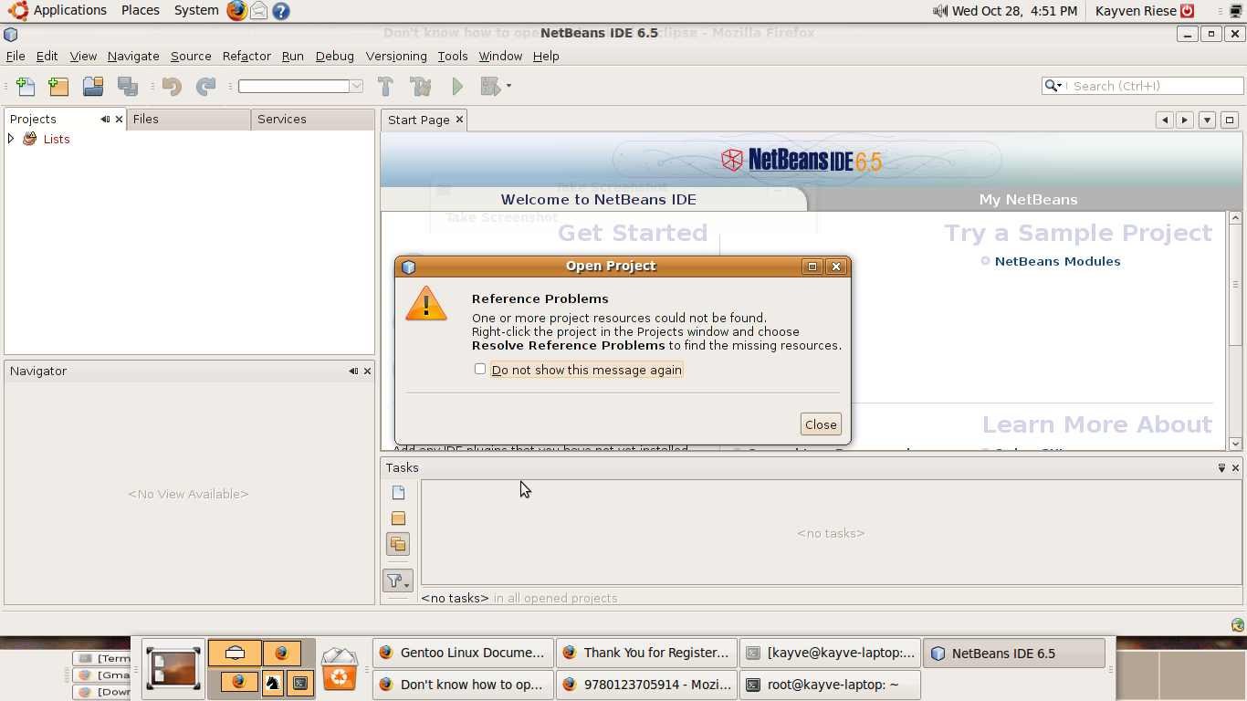

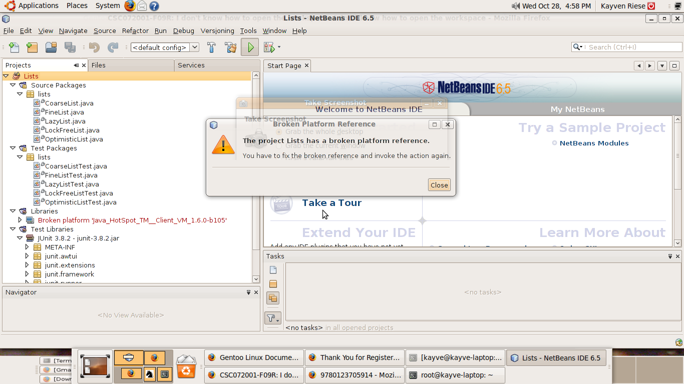

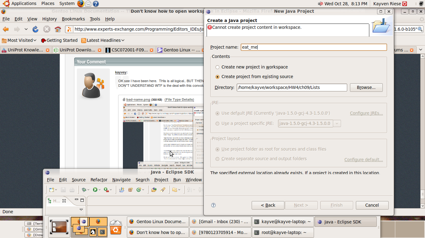

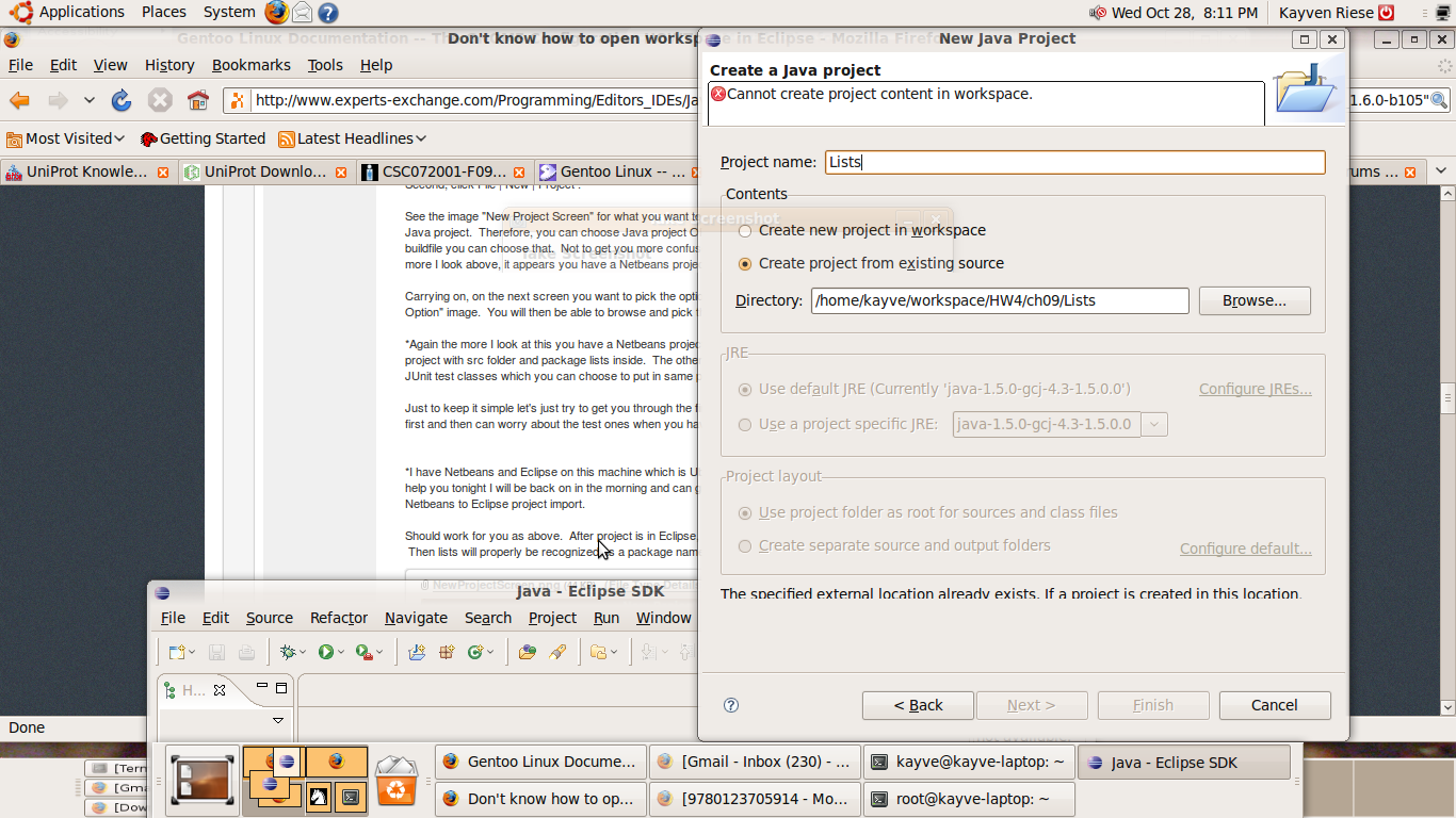

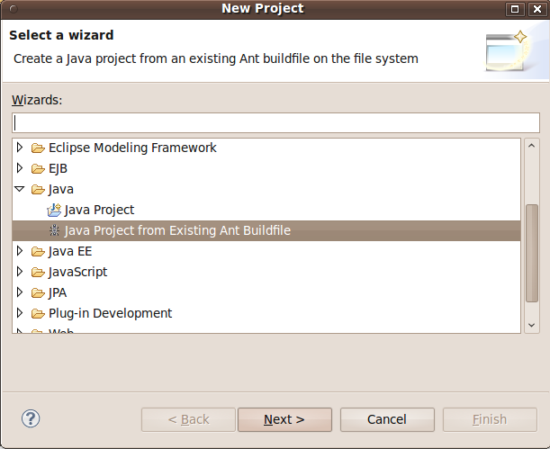

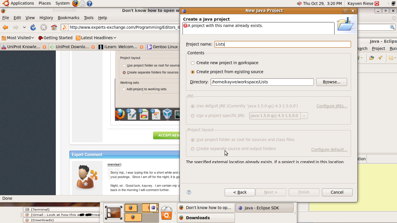

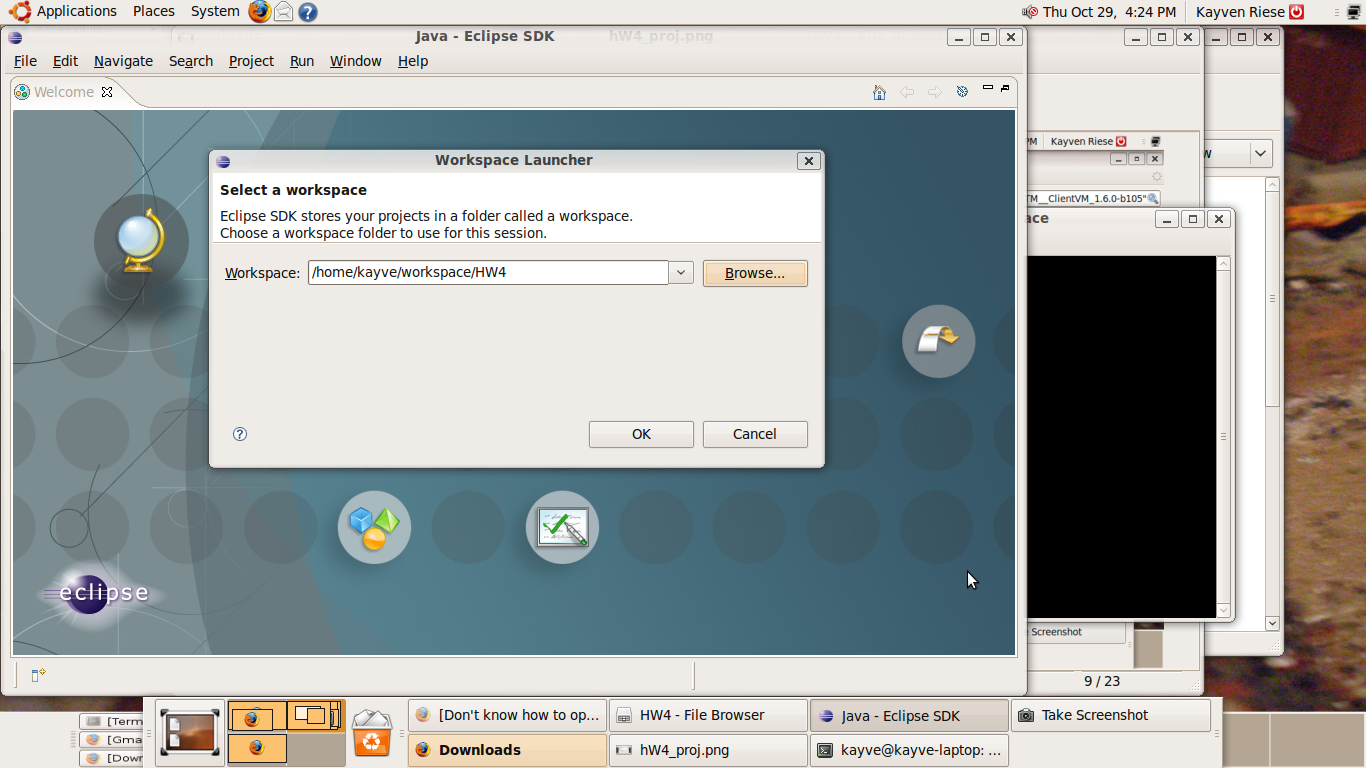

by: mwvisa1Posted on 2009-10-28 at 15:50:02ID: 25689110
Okay, think I understand so take a deep breath and see if this helps.
Switch workspace to just /home/kayve/workspace .  The HW4 structure below are your project files.  HW4 you should consider the project name and by default Eclipse will treat it as such.
Anyway, establish your workspace as root of the folder I showed if not already.
Second, click File | New | Project .
See the image "New Project Screen" for what you want to look for as suspect you are creating a general Java project.  Therefore, you can choose Java project OR if the XML file being referenced is an ANT buildfile you can choose that.  Not to get you more confused, let's just go forward with Java Project (the more I look above, it appears you have a Netbeans project that you are porting to Eclipse).
Carrying on, on the next screen you want to pick the option shown in "Create From Existing Source Option" image.  You will then be able to browse and pick the correct project folder.
*Again the more I look at this you have a Netbeans project here and looks like Lists is actually your project with src folder and package lists inside.  The other tests directory has your lists package and JUnit test classes which you can choose to put in same project in Eclipse or create a different project for.
Just to keep it simple let's just try to get you through the first step of adding the classes under src/lists first and then can worry about the test ones when you have a better understanding.
*I have Netbeans and Eclipse on this machine which is Ubuntu as well, so if my above comments don't help you tonight I will be back on in the morning and can give a more step by step approach specific to Netbeans to Eclipse project import.
Should work for you as above.  After project is in Eclipse, you can set the source folder to /path/to/src.  Then lists will properly be recognized as a package name.

by: mrjoltcolaPosted on 2009-10-28 at 16:00:31ID: 25689173
@kayvey:
Hang in there buddy, it gets better.
I think mwvisa1 is correct, you don't have an Eclipse project. That would be a .project file. You have project.xml, which I am assuming, as he said, it is Netbeans.
If you like, upload the project.xml here, or even the whole project (if it is not copyrighted) and I'll try to import it to help. However, mwvisa1's instructions are probably what you need.

by: kayveyPosted on 2009-10-28 at 16:46:18ID: 25689394
installation successful.. I guess
by: kayveyPosted on 2009-10-28 at 16:52:38ID: 25689427
oh oh.. this is looking happier, tho
by: kayveyPosted on 2009-10-28 at 16:55:14ID: 25689438
it says I have a broken platform
by: kayveyPosted on 2009-10-28 at 16:59:26ID: 25689456
Here's what happened when I hit the green arrow.
by: kayveyPosted on 2009-10-28 at 17:01:20ID: 25689463
I found a website..

by: mrjoltcolaPosted on 2009-10-28 at 17:08:53ID: 25689484
Which Java IDE is your instructor running?
As simple as the project appears to be (just 3 source files) recreating the project from the source directory should get you going in Eclipse. I don't use Netbeans so I cannot offer much help.
by: kayveyPosted on 2009-10-28 at 17:09:37ID: 25689486
oh dang
On Jun 11, 1:22 am, Paulo Cardoso <paacard...@gmail.com> wrote:
> Problem: The project uses the Java Platform called
> "Java_HotSpot_TM__Client_VM_1.6.0-b105", but this platform was not
> found.
> Solution: Click Resolve and create new platform called
> "Java_HotSpot_TM__Client_VM_1.6.0-b105".
This is true for all projects in the course labs which uses Java 6.
The problem is that at the time the labs were written, the Java
version was still in beta version. Netbeans searches the exact version
of Java specified in the project and does not find it because you have
on your machine another version.
To get around this problem, open a new project, check that the
libraries and the jdk is set to java 1.6 in the properties' project,
accessible from the contextual menu on the project's name. Then create
new classes, interfaces, etc... as they are in the original project,
copy also eventually the resources if they are any, and copy and paste
the contents of the original classes in the new classes, fix
eventually the warnings, compile and run and it should work.
There is maybe another solution, but that's the only one who has
worked on my machine.

by: mrjoltcolaPosted on 2009-10-28 at 17:17:44ID: 25689535
If you want my advice, use Eclipse.
Go back to Eclipse, create a new project, then use "Import -> File System" and import the src directory into your new project.
by: kayveyPosted on 2009-10-28 at 17:19:47ID: 25689542
Eclipse doesn't see the project.. NetBeans does.. I have been to those places above.. I am not seeing any project files. build.xml clearly says "NetBeans" in it...
but okay.. those directions do say recreate everything.  I will see how it goes then.
by: mrjoltcolaPosted on 2009-10-28 at 17:21:20ID: 25689554
I said "create a new project, then use "Import -> File System" and import the src directory into your new project."
by: mrjoltcolaPosted on 2009-10-28 at 17:22:01ID: 25689559
We are getting overlap. Yes, that is because project.xml is a non-Eclipse project and unfortunately, mwvisa1 went to bed. :(
by: mrjoltcolaPosted on 2009-10-28 at 17:24:26ID: 25689575
Or.. you don't even have to use the import feature. Once you've created the empty project, simply copy the src and test directories (with contents) over into the root of the new project using filesystem commands. Then use F5 or Right-click on the Project and pick Refresh, and Eclipse will see the new files.
by: kayveyPosted on 2009-10-28 at 17:25:52ID: 25689583
I always get confused creating projects it wants it to have a certain name..
by: mrjoltcolaPosted on 2009-10-28 at 17:29:12ID: 25689598
The project name will simply be the upper level directory. The original project is called Lists, so you could keep it the same, or name it Homework4, or HW4. Whatever you name it, you'll end up with an Eclipse project. Then, you can fix all of your professor's projects to modernize them to Java 6 and Eclipse. :)

by: kayveyPosted on 2009-10-28 at 20:12:33ID: 25690388
OK see I have been here.  THis is all logical.. BUT THEN THE DANG THING DOES THIS TO ME!!!! I DON"T UNDERSTAND WTF is the deal with this convoluted naming nonsense!
by: kayveyPosted on 2009-10-28 at 20:13:44ID: 25690392
No name is good enough for this pig
by: kayveyPosted on 2009-10-28 at 20:57:08ID: 25690546
Looking at what this idiot application does
by: kayveyPosted on 2009-10-28 at 20:57:26ID: 25690548

by: kayveyPosted on 2009-10-28 at 22:08:03ID: 25690800
oh.  I called it "HW4" and it grabs HW4. I really hate the way it makes me use the directory it thinks
by: kayveyPosted on 2009-10-28 at 22:09:32ID: 25690802
I didn't do the right thing. Nothing's there.
by: kayveyPosted on 2009-10-28 at 22:11:18ID: 25690807
okay now I am trying to import. I think I screwed up again.
    • 151 KB
    It went blank when I went too deep in the hierarchy

by: kayveyPosted on 2009-10-28 at 22:16:22ID: 25690825
I moved everything to ~/workspace/Lists now I am switching to that workspace I hope

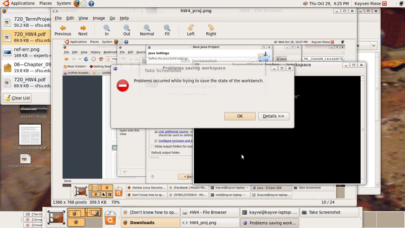

by: kayveyPosted on 2009-10-28 at 22:20:19ID: 25690844
*@&# I went to the restroom and back (way down the hall) and Eclipse is still thinking
woaaah

by: kayveyPosted on 2009-10-28 at 22:40:22ID: 25690934
here is another file

Open File is not the thing?
by: mwvisa1Posted on 2009-10-29 at 06:16:10ID: 25693253
kayvey,
Please calm down.  You are only going to make things worst for yourself.
As stated before, you don't want to switch your workspace to the folder with your code as that is the project folder.  Leave your workspace as ~/workspace.
Follow my instructions and pick Lists folder now that you have moved it up to root of workspace.
You had this before when you showed picture with HW4.  What you had to do next was my instructions that said to "After project is in Eclipse, you can set the source folder to /path/to/src.  Then lists will properly be recognized as a package name."  What this means is in the screen pictured by HW4-proj.png you would change the source folder to the correct path to Lists/src.
However, since you have moved the contents to workspace hopefully with this structure:
Lists
  src
     lists
        SomeJavaClass.java
You should follow my instructions again and when you pick Lists, Eclipse should automatically make src your source folder.  If it doesn't do same thing mentioned earlier to mark it as such.

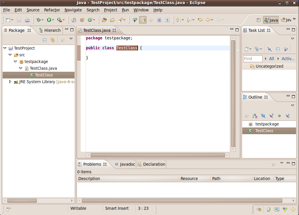

Create dummy existing project folder :
  1. Open Places | Home Folder, then Open workspace.  If you prefer terminal or other means, please do what is comfortable.
  2. Create a folder in ~/workspace called TestProject.  This is the project folder.
  3. Open Test and create a sub folder called src.
  4. Open ~/workspace/TestProject/src and create a sub folder called testpackage.
  5. Open ~/workspace/TestProject/src/testpackage and create a text file called TestClass.java.  If you want you can fill with content like :
package testpackage;
public class TestClass {}
Content is not needed, but will help have a clean (no errors) project once we are done.
When you get this far, please post back.

Now, let's bring project into Eclipse :
  1. Open Eclipse, selecting ~/workspace if prompted
  2. File | New | Java Project OR File | New | Project and choose Java Project
  3. Click "Create project from existing source" radio button
  4. Click browse and navigate to ~/workspace.
  5. Click on TestProject (don't open, just highlight folder) then click OK
  6. Click Finish
You should now have a project in Eclipse and should look like the attached image which will show the following :
  • Project named "TestProject"
  • Source folder "src"
  • Package name "testpackage"
  • Class file "TestClass.java"
If your environment doesn't look the same, then please let me know.  Otherwise, that is it! :) Therefore, you are ready to try the same process on Lists project.
If you have issues with that, then post back before trying anything different.
That way we can do a little troubleshooting with what exactly is different between the simple project we just used here and the Lists project itself. :)

I changed the "workspace" as in the very first comment.. but it still won't let me create a "project from existing source."
by: mwvisa1Posted on 2009-10-29 at 15:38:30ID: 25698926
Please do exactly what is in my last two posts step by step.
by: kayveyPosted on 2009-10-29 at 16:15:35ID: 25699104
I don't know how to get back to HW4_proj.png  {:(

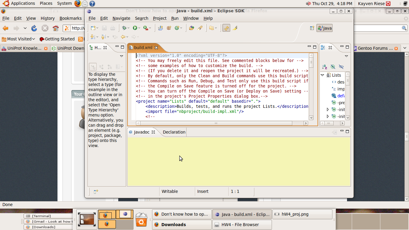

it DOES think build.xml is an ANT file.. it has the little creepy iconography...

I got to HW4_proj.png by creating a new project called 'HW4," but I think I moved all the files since then...

as for the ease of "creating a project" I have displayed multiple screenshots of the failure of the creation of a project. THe arrows are greyed out until I type a name, and no name I can type is "correct" they all show errors.  The one time that didn't happen was when I created the project "HW4_proj.png" but as I have written, I think when I did that the Lists where inside HW4 directory.  Maybe I am wrong about that but you should know it is difficult to get details right sometimes, for me these damned directory games eclipse plays.. I have been struggling with this .. I was in a team project situation and my impatient teammates kept doing it for me and not explaining..
I knew it was a good thing when I created HW4_proj.png.. but I SCREWED UP AND THAT IS GONE AND I DON"T KNOW HOW TO GET BACK.

I thought you said to move the files and I thought I got to HW4_proj.png by importing but now I get this error.

I think I brought the src file in using the import directory like you said. I think I have done that before. I bought the O'Reilly book on eclipse a while back and figure that out.. This creation of projects to me... I don't know.. I don't feel it was covered so well I guess.
