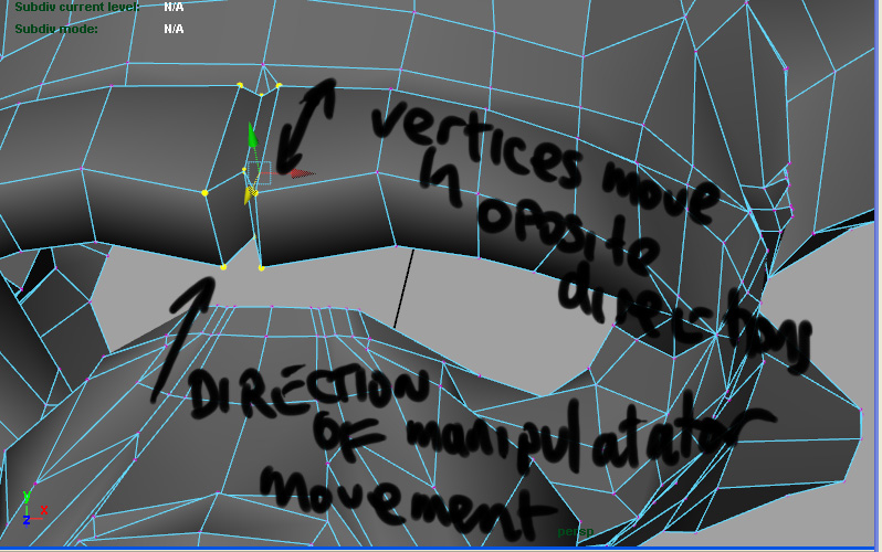

I have a problem where i select multiple vertices of a model. when I move the vertices the move in oposite directions to each other not together as I would expect. I ahve attached a picture to show this

by: kmead6Posted on 2009-09-19 at 01:22:12ID: 25372045
did you duplicate special or mirror the geometry?
by: funkimunkyPosted on 2009-09-19 at 08:42:27ID: 25373414
thanks for chipping in to help me.  I mirrored the geometry, I made half the head first then mirrored it does that cause a problem?
by: kmead6Posted on 2009-09-19 at 11:45:45ID: 25373995
hmm... did you try deleting the history for the geometry? another thing might be when you mirror the geometry did you make sure in the options that "merge with the original" and "merge vertices" were checked? or one last option would be to check the direction of your normals. you may have to reverse the normals on the side you created when you mirrored.
i've had this problem before but because i used duplicate special and had the wrong geometry type selected. let me know if any of this works.
by: funkimunkyPosted on 2009-09-20 at 02:19:21ID: 25376398
how do I reverse the normals, I know how to view normals but I'm not sure how to reverse them.
by: kmead6Posted on 2009-09-20 at 13:22:06ID: 25378787
once you view them, select the ones that you want to reverse then from the Polygons menu choose Normals -> Reverse
by: funkimunkyPosted on 2009-09-21 at 09:09:48ID: 31630782
I'm gonna accept this as you did answer some of my questions. I found a solution here
http://area.autodesk.com/forum/autodesk-maya/autodesk-maya-2008/move-tool---mirror-option-bug/
I had set mirror option on my move tool and this has somehow broken the application but the above link tells you how to fix.
