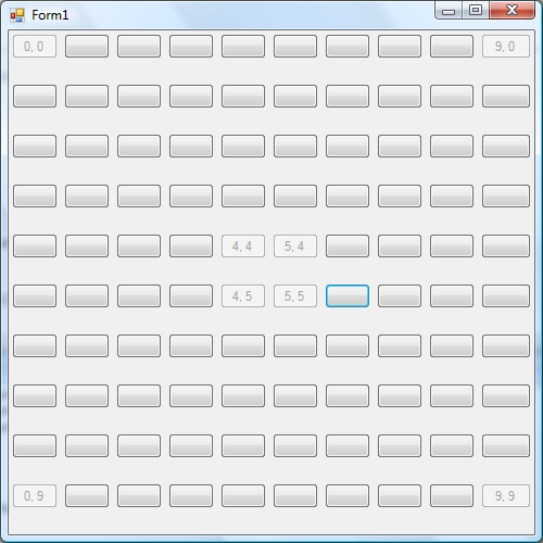

If you have VB.Net 2005 (or above) then you could use a TableLayoutPanel to help you arrange the Buttons in a nice Grid.  Then you can place the TableLayoutPanel into whatever container you want on the Form and your Buttons will resize themselves automatically.
This would be an example of newyuppies method "b".  I'm creating the Buttons dyanmically at run-time and adding them to the TableLayoutPanel.  I use AddHandler() to wire them all up to the same method.  When the buttons are clicked they report their position in the Grid and disable themselves.  You can hit the Escape key to reset them.  This also demonstrates how you could iterate over all the Buttons to make decisions about the game.

    Private Sub btn_Click(ByVal sender As Object, ByVal e As System.EventArgs)
        Dim btn As Button = CType(sender, Button)
        Dim pos As TableLayoutPanelCellPosition = tlp.GetCellPosition(btn)
        btn.Text = pos.Column & ", " & pos.Row
        btn.Enabled = False
    End Sub
