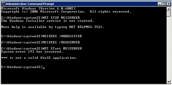

Try this: in the "Run..." box, type "msiexec" and press [Enter].  You should get a box telling you what all switches you can use.  If so, that's a good sign, and we know the actual executable is working.  Then, from a command prompt, perform the following:
  1.  NET STOP MSISERVER (it is likely not running, but do this just in case)
  2.  MSIEXEC /UNREGISTER
  3.  MSIEXEC /REGSERVER
If you see no errors in step 2 or 3, then try to re-install the MSI package again.
If you get an error when trying to run "msiexec" (not a valid Windows application, or similar), then I have some ideas for getting a new executable, but I'm still thinking...
by: kirretPosted on 2009-09-21 at 15:45:46ID: 25388352
Hi and thanks for your efforts
I have done as you asked. I have added a screenshot (screen.jpg) so you can see what I've done.

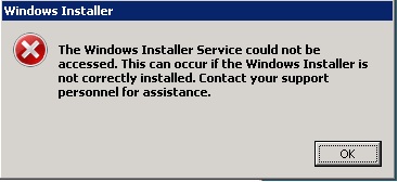

I run those 3 lines, first one failed, saying it wasnt running anyway. 2nd and 3rd, I got no answer, maybe thats how it should be. Then I thought that maybe I should run NET START MSISERVER. but that gave me an error. I also tried running those msi-files again and same as it was before, check screen2.jpg
So any more thoughts would be very welcome.
