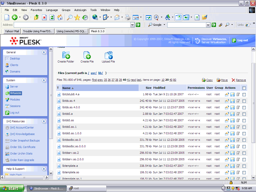

by: EMB01Posted on 2008-05-16 at 07:04:50ID: 21582747
Yes, it is installed at that location. I have attached a screenshot so you can see.
by: gheistPosted on 2008-05-16 at 07:45:20ID: 21583182
Then follow instructions, but use correct tdsodbc library name.

by: EMB01Posted on 2008-06-06 at 11:51:24ID: 21731767
"ldd /usr/lib/php/modules/mssql.so" returns:
        libsybdb.so.5 => /usr/lib/libsybdb.so.5 (0xb7f7e000)

One last question: My host recently updated the thread concerning issues with the MSSQL connectivity. The post:
"I was able to successfully install the FreeTDS RPM on a (dv) 3.5 after installing a backwards-compatibility package for readline, that will allow readline 4 to be accessed while readline 5 is installed.
The package I found (by searching rpmfind.net for libreadline.so.4) is located here:
ftp://rpmfind.net/linux/sourceforge/m/m & 7.i586.rpm
root@dv35 ~]# rpm -ihv readline-compat-4.3-307.i586.rpm
Preparing...                ########################################### [100%]
   1:readline-compat        ########################################### [100%]
[root@dv35 ~]# rpm -Uhv freetds-0.63-1.1.el3.rf.i386.rpm
warning: freetds-0.63-1.1.el3.rf.i386.rpm: Header V3 DSA signature: NOKEY, key ID 6b8d79e6
   1:freetds                ########################################### [100%]
Hope this helps."
When I try to do this (rpm -Uhv freetds-0.63-1.1.el3.rf.i386.rpm), I get the following error:
error: Failed dependencies:
        libct.so.4 is needed by (installed) freetds-devel-0.64-11.el5.centos.i386
        libtds.so.5 is needed by (installed) freetds-devel-0.64-11.el5.centos.i386
        freetds = 0.64-11.el5.centos is needed by (installed) freetds-devel-0.64-11.el5.centos.i386
Do I need to solve these dependencies and can't I just use Yum for this? Also, when I install "libct.so.4" I get an error depending on the install of "freetds = 0.64-11.el5.centos is needed by (installed) freetds-devel-0.64-11.el5.centos.i386" - how do I install that one?

freetds is installed and correct version. do not install old version.
by: EMB01Posted on 2008-06-09 at 05:44:22ID: 21742705
Right now, if I run odbc_connect, I get an error reading "SQL error: [unixODBC][Driver Manager]Data source name not found, and no default driver specified, SQL state IM002 in SQLConnect." What if the new version of the driver doesn't support the actions of the old version from the tutorial (http://kb.mediatemple.net/questions/233/Using+%28remote%29+MS-SQL+databases+with+PHP+on+a+%28dv%29)?
