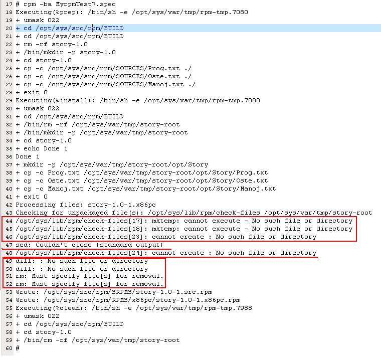

Here is the content of spec file. I tried to build "rpm file" from attached "spec file" with following command and following the output during execution. i believe output is not as per expectation.
spec file is in attchment.
output of building rpm from spec file is also in attchment as image file . i marked error in image with red color please help me to reomve red color mark.
The "mktemp: cannot execute" error in /opt/sys/lib/rpm/check-fil
! Posting a JPEG image is OK, but next time please *also* attach the .rpm.tmp file like you did previously.

Processing files: story-1.0-1.x86pc
Checking for unpackaged file(s): /opt/sys/lib/rpm/check-fil
/opt/sys/
/opt/sys/lib/rpm/
/opt/sys/lib/rpm/
sed: Couldn't close {standard output}
/opt/sys/lib/rpm/ch
diff: : No such file or directory
rm: Must specify file[s] for removal.
Wrote: /opt/sys/src/rpm/SRPMS/sto
Wrot
Executi
+ umask 022
+ cd /opt/sys/src/rpm/BUILD
+ cd story-1.0
+ /bin/rm -rf /opt/sys/var/tmp/story-roo
PLEASE HELP ME TO RESOLVE THIS ISSUE.
