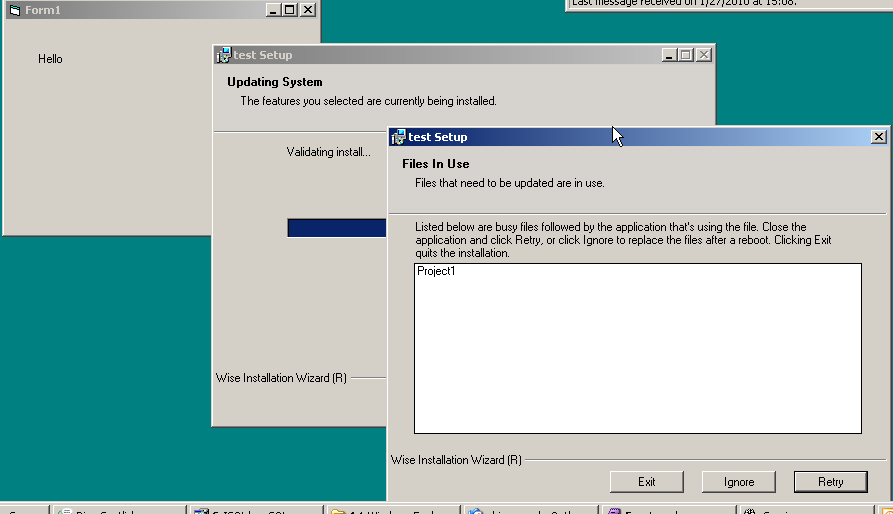

I just made little experiment: created trivial vb6 application project1.exe v. 1.0 and placed it under program files\test; recompiled project1.exe with v.2.0 and created installation that would install project1.exe 2.0 into the same program files\test; ran project1.exe, then launched the installation. As expected, it showed the dialog "files in use". I will attach this sample here so you can try it out (rename installation.txt to .msi and project1.txt to .exe). My version of windows installer is 4.5.

by: vadimrapp1Posted on 2010-01-28 at 05:50:52ID: 26427372
> none of the answers worked.
In the id 25059875, I uploaded sample installation that I built and verified. To double-check, I just re-downloaded it now, ran it, and it showed "files in use" dialog - see the picture. Did you try that?
