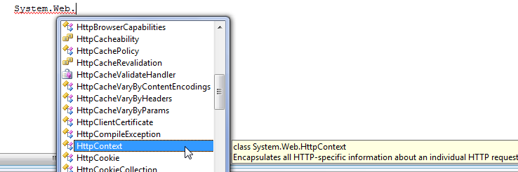

by: abelPosted on 2009-08-31 at 07:46:57ID: 25223213
Actually, there is. Check your references as explained above. See the screenshot. Perhaps your local browser (class browser) has it wrong. You cannot always trust the intellisense.
These classes are around since asp.net 2.0. If you add the reference to a non-asp.net project, you can still access them. Try typing them in as some experts have shown you and try to compile.
You do not need to add System.Web in front, if the "Imports System.Web" is in place on top of your class, you can use it without.
-- Abel --
PS: when you check the references, you can also check if the correct dll is installed here: %SystemRoot%\Microsoft.net\Framework\v2.0.50727\System.Web.dll
