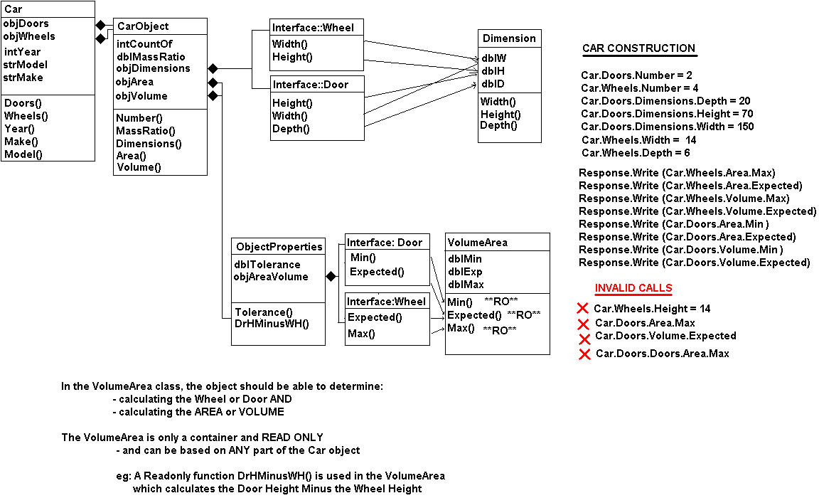

I am looking for is mainly some guidance in this subject rather than solving a specific problem presented here. If the examples I have given can be solved, this should help me on my development futher.
I am trying to develop is a self contained object which contains all the properties and classes using inheritance, polymorphism and interfaces.  However, I am running into difficulty setting the object up without causing errors and not being able to have the expected visibilty that I require.
The example I have been working on is based on a Car object, and has various objects including a couple of Doors and a Engine with various properties, methods and attributes.
What I'd like to be able to do with this Car object is a number of things:
      1. Self Contained
                The Door and Engine cannot exist on their own without the Car object. Additionality,  the Door Handle cannot exist without a Door. These objects should be visible when using the IntelliSense when coding the Class.
      2. Reusability
                I have created a Dimension Class and would like to reuse and apply the class to any current/future object created at a later stage which may require these properties. However, if the property is not required. For example, a Windscreen Wiper class requires only a length field, so I can hide the Height and Width properties when creating this object.
      3.  Interfaces
                I have limited the interface of the Class to only what I have provided through the various properties and methods using Interfaces to ensure objects are being using in the right way and call at the level in the object.   For Example, preventing typing source code with a reclusive call like Car.Door.Door.Door.... or being able to call something that doesn't make sense Car.Engine.DoorHandle.
       4. Visiblity
                If I am in a nested class, I should be able to read, but not update any properties of the parent class which I am currently accessing. For example, If I am in the Engine class, I'd like to still be able to see the Year at the Car Class level.
        5. Methods
              I would also like to how to call a method from a class to another class object either or a nested class inside. For example, If I have a Door Handle with a method called Pull(), this function calls a function in the Door object which Opens the door. Similarility, If I have a Fuel Cap Door, the only method aviable would be Push() which opens the fuel cap "Door".
