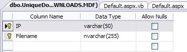

Tracking Database
I designed a simple one table database in the App_Data folder of the solution for this.  Ideally for normalization, you would want one table to list files, and a detail table that shows the downloads for each file, but for the sake of simplicity I created two columns:  IP and Filename, both text types.
  • 12 KB
  • Table definition
Table definition
The connection string is stored in the web.config in the connectionStrings section.
